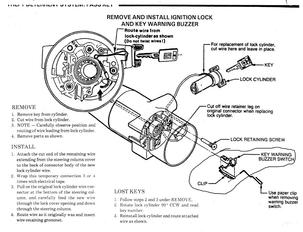

Did you put the piece circled in this picture back in correctly?

thanks. I dont remeber there being a wire on the old ignition. And I know I never cut any wire.

You didn't cut any wires off yours. This picture shows the VATS lock cylinder and was used for a reference to show the key warning buzzer only.
