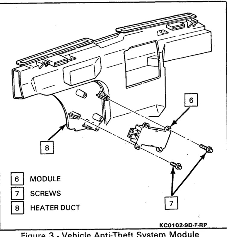

It is located on the firewall near the drivers right knee below the defroster ducts and is a royal PITA to get to. For easier access to it, remove drivers seat and center console first. While doing this procedure, it is advisable that you do not have any young impressionable children or anyone who has what might be termed "delicate ears" in the general vicinity of your work area. Here is a picture of its location in your car.

thanks for the pic.
that pic will definetly help. picking up a module and lock tomorrow. son (19 yrs old) is doing most of the work, i'm getting to old for this stuff.
i've been told that bypassing the resistor key can cause module to eventually go bad. maybe the constant activation of the module eventually destroys it??
it must be behind the insulation??

does the heater box have to come out also
i have dash removed and defrost ducts and still can't find the SOB
to get to the area behind the defros ducts, it looks like the heater box has to be removed??

No the heater box doesn't have to come out.
