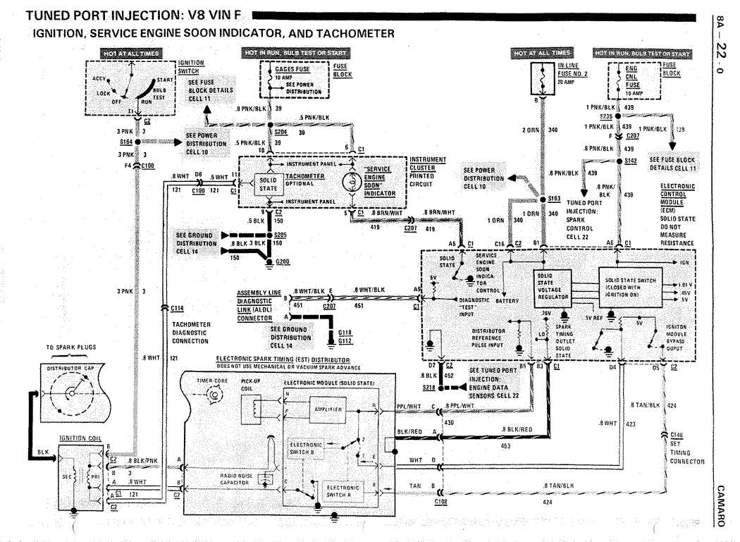

Can anybody please tell me the path the white tacho/computer wire takes as it leaves the coil?
As in; Coil, through fire wall, gauge cluster, then computer?
I have a bad short on it and i cant seem to follow it around so i just wanted to replace it.

Maybe this will help, it is out of a 89 service manual but the wiring is the same on this.

Thanks matey. As it turns out, the wire had been re-directed into my immobiliser first and that was what was damaged and causing the short.
