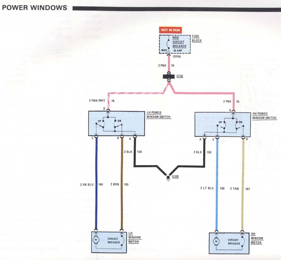

Hey all, i just picked up a parted out iroc with power windows, so i took the center counsoul and all the wiring with it, how do i go about powering the power windows, ive got the wires that go from the switches to the doors to under the dash how do i power it up. any help is great

try this.... each window has a connector that goes thru each door to the harness.....

sweet dude!! exactly what i needed !!:lala: :lala: :hail:

thanks to that picture i now got mine fixed!!!
thanks for posting that!!!
