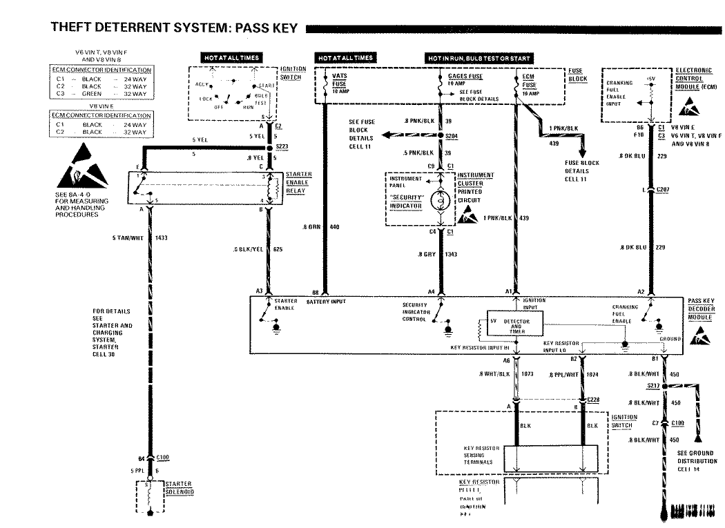

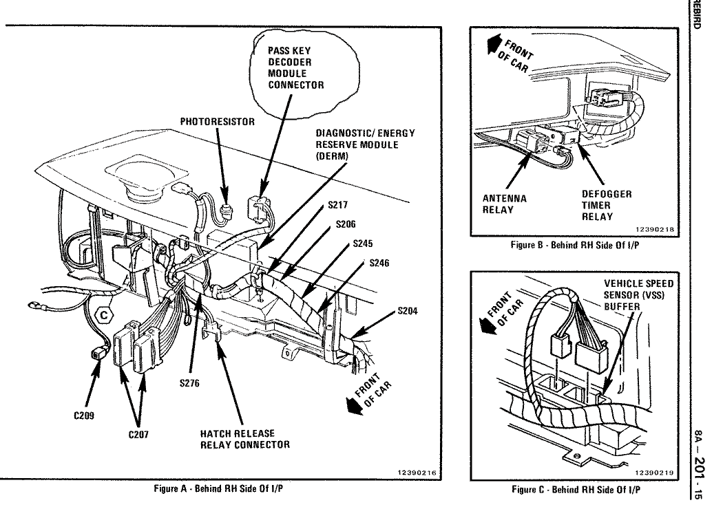

ok I need some help. I am having a problem with my VATS system and I need to check the VATS control box( Relay, whatever). The thing is I dont know where it is. I have a 91 firebird formula 5.7 350. If anyone has pics or can help me find it it would be great thanks

Hello Abanda,
Here is a schematic of your cars VAT's system and a picture of the location of the VAT's control module.
Please note the number of wires going to the VAT's control module as shown in the schematic as well as the color coding of each wire. This will help you determine which component is the VAT's control module.

page 2

Are the VATS wires always going to be black and white and purple and white regardless of year and model , I have a 92' L98 Z28
No they will vary from different years and models. On your car they are white/black & purple/white. On my 89 Iroc they are white/black & purple/yellow.
