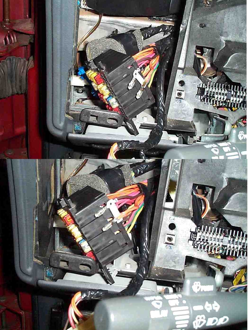

so i have a 85' T/A and the air doesn't work unless i push up on the fuse box. right when i let it drop a lil' my air turns off... im not sure where to tighten it and i don't wanna tear it apart and open a can of worms i can't fix so a lil' advice would be helpful,. thanks.

There may be little other choice than to inspect the fuse panel. Ignoring an intermitttent power connection can only invite more trouble, and none of that is good. we don't want to lose another ThirdGen to an electrical fire.
That would be the extreme case, but this is what you might discover:
