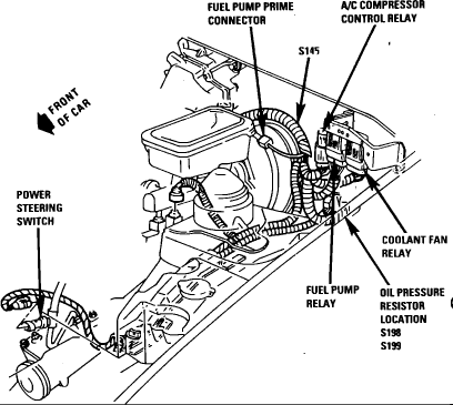

Aight, I need some fan help
What do I need to do to test the fan core/motor to see if it died on me?
I just want to check it, to see if it still works.
NOTE: I have the fan motor set to constantly on.

Jumper pins "A" and "E" on the cooling fan relay. In case you don't know where this relay is, look at the picture below.
Pin "A" wire = Red
Pin "E" wire = Black/Red

Thanks bro.
It was the inline fuse I had on the line.
It was fawking fried.
replaced it, its all good now.
Thanks
