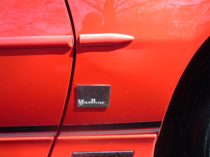

Hi,
I just purchased a 1990 Iroc Convertible and the tach reads way to high? There is no way that I am shifting a stock 305 at way past 7000RPMs.
Question: Did someone change the dash for a v-6 dash? I know the mileage is not correct. Would getting a v-8 dash correct this?
Another Question: Does anyone have any infomation on the Marlboro giveaway for the 1990 Iroc? This is a giveaway car and would like some information?
Thanks
