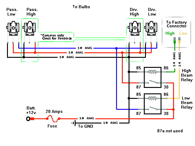

Im thinking of doing this dual intake system for my camaro. The camaro has 4 headlights. I want to take out the inner headlights (High Beams) and put my air filters in its place.
Now the question is can i just use one head light for both High/Low beam for each side (passenger/Driver) Planing on doing the HID conversion and use these HID bulbs. They say that they are high/low beams. Whats involved in doing this?

So what would the wire diagram look like then, Cause how will i still control the high beams with the headlight switch? I think im making it harder than what it is LOL. I have a brain fart right now that just wont pass

Hmmm.....It'll take me a bit (if i even can) figure out how to turn Camaro into Firebird wiring.
Are the 4 Camaro light only 2 wires each? 1 Power, 1 Ground?
If so.....The Pontiac light plugs are 3 wires..1 High Power, 1 Low Power & 1 Ground.
Seems TOOOO easy, but could you just reroute the Hi & Low power wires to 1 Pontiac plug, and plug it into a dual Hi/Low HID bulb?

its wired just like this. So low beams have 3 wires and the High has 2. So your saying that all i need to do is get a firebird 3pin connector and from there use the HID to the New H4 head light? That sounds like that might work

Oh yeah....The Low beam is a dual (Hi/Low), the the Hi is just the single. Been a long time since I had a Camaro and messed with the headlights. I converted my Camaro headlights into police-style wig-wag headlights, when I was a volunteer Firefighter.
I'm not 100% certain, but I was thinking the middle connection on the Firebird plug was ground, but who knows.....You just might be right. If not, just a simple matter of switching black with red or blue, so no big deal.

The outer headlights are a high and low beam bulb already. That particular HID bulb you show I wouldn't use. Those were the first ones I bought too a few years ago, and that little bulb off to the side is the high beam that is WAY off of the focal point of the housings and puts out basically no light. There are other h4/9003 bulbs that use HID on high and low beam, which I have and still don't think they're that great as far as difference between beams but are still far better than that one you found.
