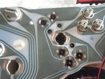

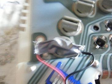

this is my damaged circuit board

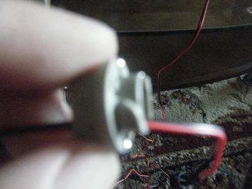

this is the factory connector with my led wire running through it.

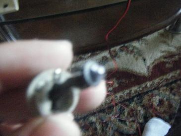

this is the led itself

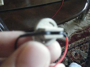

this is how i locked them in place, i pulled it tight and tucked them at the ends
this is the connecter with the led inside on the circuit board with the duct tape to hold it in place

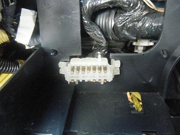

this is the connector that youll be using, the one closest to the dash dimmer switch
the connector pin that im pointing to is he one for the dimmer/ dash lights, its a grey cable, I cant show but i spliced into it
I used the ground on the same plug its the top left one (above the one im pointing to)

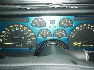

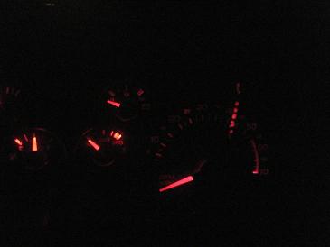

This is my dash at day
this is the left half
the right half
