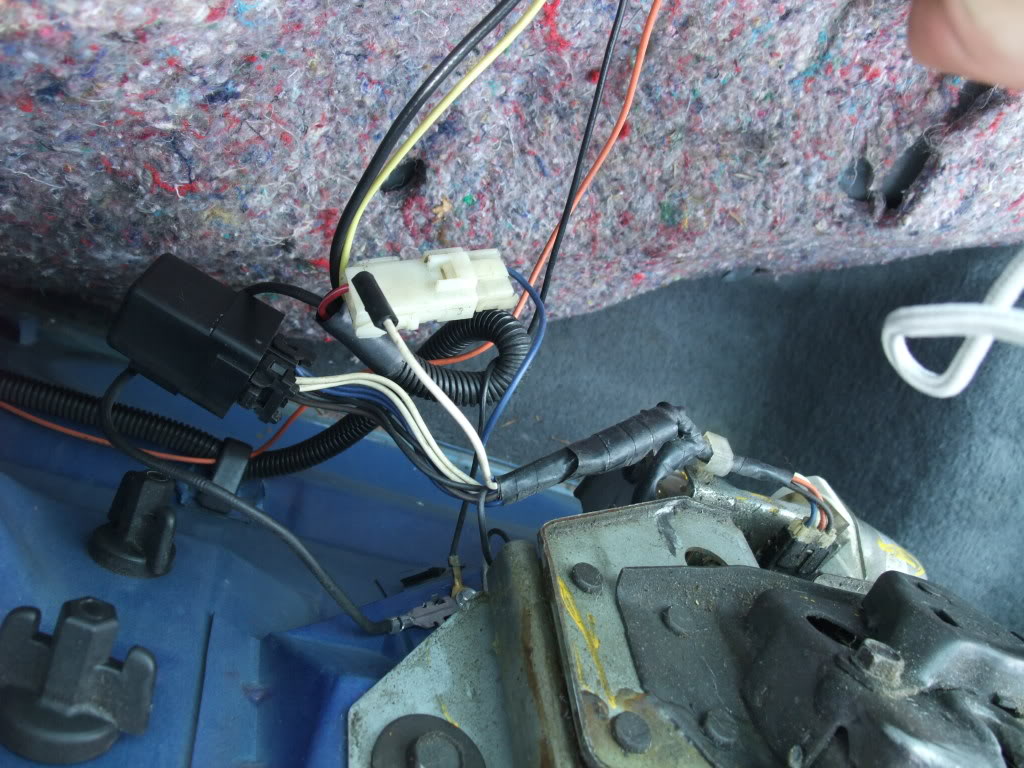

Well, I had a problem where my hatch pulldown decided to never stop running. The hatch would pulldown, then the motor would keep running.
I was at a concert at the time, unplugged it, and forgot about it.
I've now decided to try and get it working, but I cant seem to figure out where a wire goes. Its the loose white wire in the center of the picture.
Tips on where it goes?

If your pull-down unit just runs without stopping the gear nut is badI sell it as TDS p/n 109111, $7.95.
That white wire isn't plugged into anything on your year of F-body. It was used on 1990-91 model years to turn on and off the rear hatch light. For those model years it plugged into a black with orange stripe wire.
