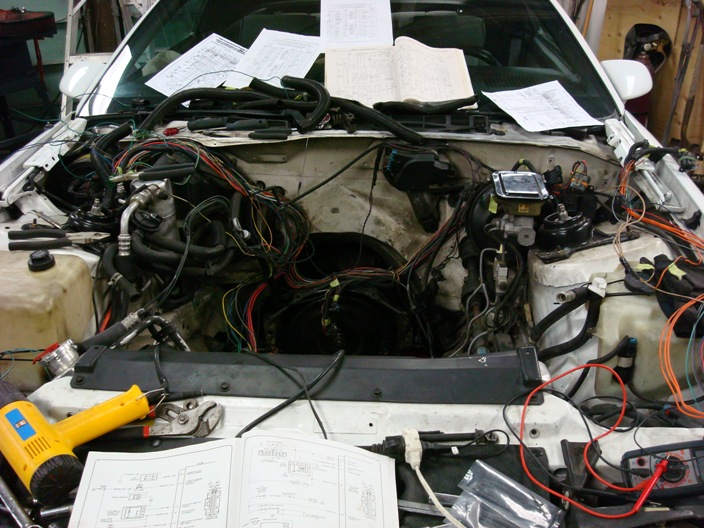

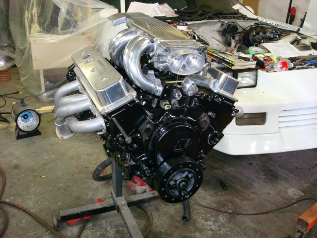

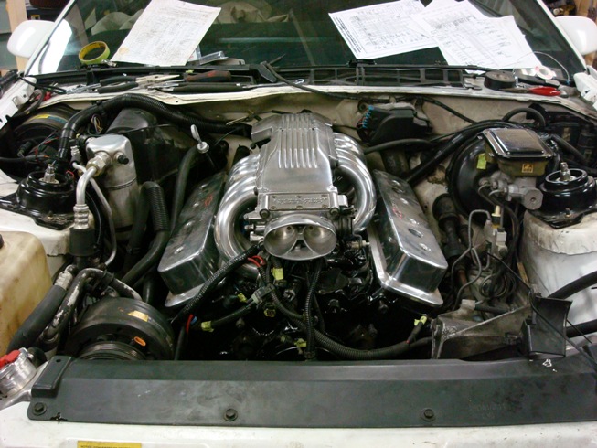

just cuz we all like pictures
Attached Thumbnails vss speedo problem cant decide if its the buffer box-feb-09-engine-swap   vss speedo problem cant decide if its the buffer box-feb-09-engine-swap   vss speedo problem cant decide if its the buffer box-feb-09-engine-swap
Old Dec 18, 2009 | 09:26 PM
91RS_Charlotte's Avatar
Joined: May 2009
Posts: 46
From: Charlotte, NC
Car: 1991 Camaro RS
Axle/Gears: 3.42 Std
Re: vss speedo problem cant decide if its the buffer box
Nice looking engine!
