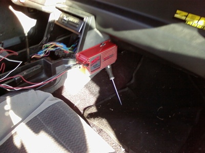

you still need to run a coil. dl the MSD 6AL install instuctions and read the section for your app. If my memory is right you have a 4 prong ignition control module... to install the msd you take the module out and hook the msd into the wires the module was hooked into. do yourself a favor and buy the msd adapter harness. where are you mounting the box?
Old Dec 4, 2009 | 07:17 PM
camaro_doc's Avatar
Joined: Mar 2004
Posts: 90
From: Gettysburg, PA
Re: MSD 6AL, what do i need?
Here is where i am mounting my 6al
