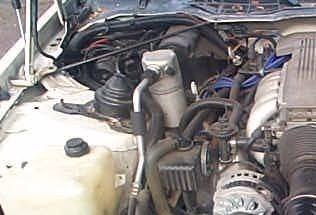

Do i need this?????
Hello i took my A/C out but i still want to keep my heater and i was wondering if i need this or not . i was talkin about the whole black thing on the firewall.

you gotta have something so the blower motor vents into the car,you can get an ac delete housing though

but i meant that i wanted to get rid of whole thing except the blower thing

Something must remain. Either find a non-AC box or modify that ones to suit. DIY jobs are found in the fabrication forum. Some clever and innovative, some... not so much
