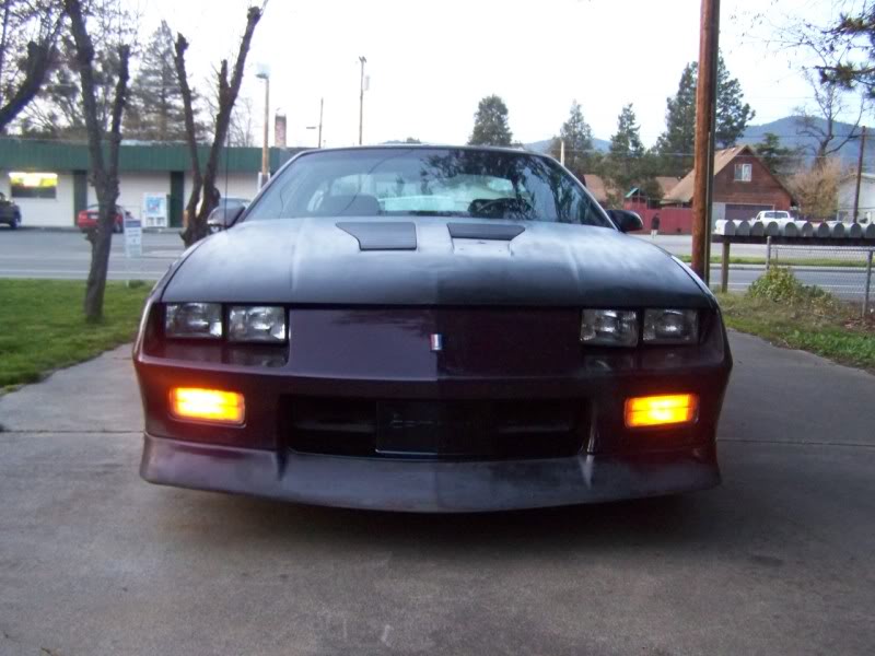

I know this is not for everybody,....but for those of you who like to drive with your parking lights on, (or running lights) this is something you might actually like.
As long as I can remember, I've always prefered to drive with my parking lights on. Then when the C5 Vettes came out and had those bright amber DRL's, I knew I wanted not only a black C5 Vette, but also a way of giving my own car that same look. Fortunately I ended up with both!
Anyway, there's a company out there that sells a module which will allow "ANY" car to have DRL's. (regardless of the year, make, or model) I posted a link to their web page down below. Here's a couple pictures of what they look like on.................oh, and pardon the "work in progress" I call my 91 RS.
**EDIT** I removed part of this post because of it going off the main topic. It was intended to promote the DRL option for 3rd gen camaros.
Ok, the company that sells this module is called: Web Electric Products. Once you click on the link, you'll see on the left side of the page where it says "Daytime Running Lights". Click on that and scroll down to the bottom. It's going to be the Universal DRL1 Kit that you want. The nice thing about it is, it only takes like 30 minutes to install.
Here's the link: http://webelectricproducts.com/products.htm

Here's the thing though,.....that's not why I started this thread. I thought that maybe somebody else here might like to have this DRL option on their car. (That's it) So, before this happens to take over the thread, I'm going to delete the whole ticket/law subject.

I actually want to use my parking lights & my fog lights as DRLs. In fact, I do.
I always just flip my parking lights on, after I start the car. Automatic DRLs would save me the hassle of flipping my switch. It just hasn't bothered me enough to get in to my dash & rewire it yet.
Do you have another way to do this, other than rewiring the switch as key on=power to the lights?
Being a Firebird owner, I don't want my headlights to pop up during the day, to use as the DRLs, but use my fog lights instead. For Camaro owners the headlights would be OK to use.

free if you have a relay and some wire, maybe some diodes. run a relay to keyed power and have the outputs go to the brown wire in the headlight switch for parking lights. got fogs too? then just add to the output with a diode to separate the circuits and you got parking/fogs on with the key.

Yeah, but DRL's run the parking lights with both filaments lit, not just one like our stock headlight switch does when you turn them on.

This module would make your turn signal into DRLS. You don't have to touch your ignition or even get into your car. It simply ties into your existing turn signal harness.
