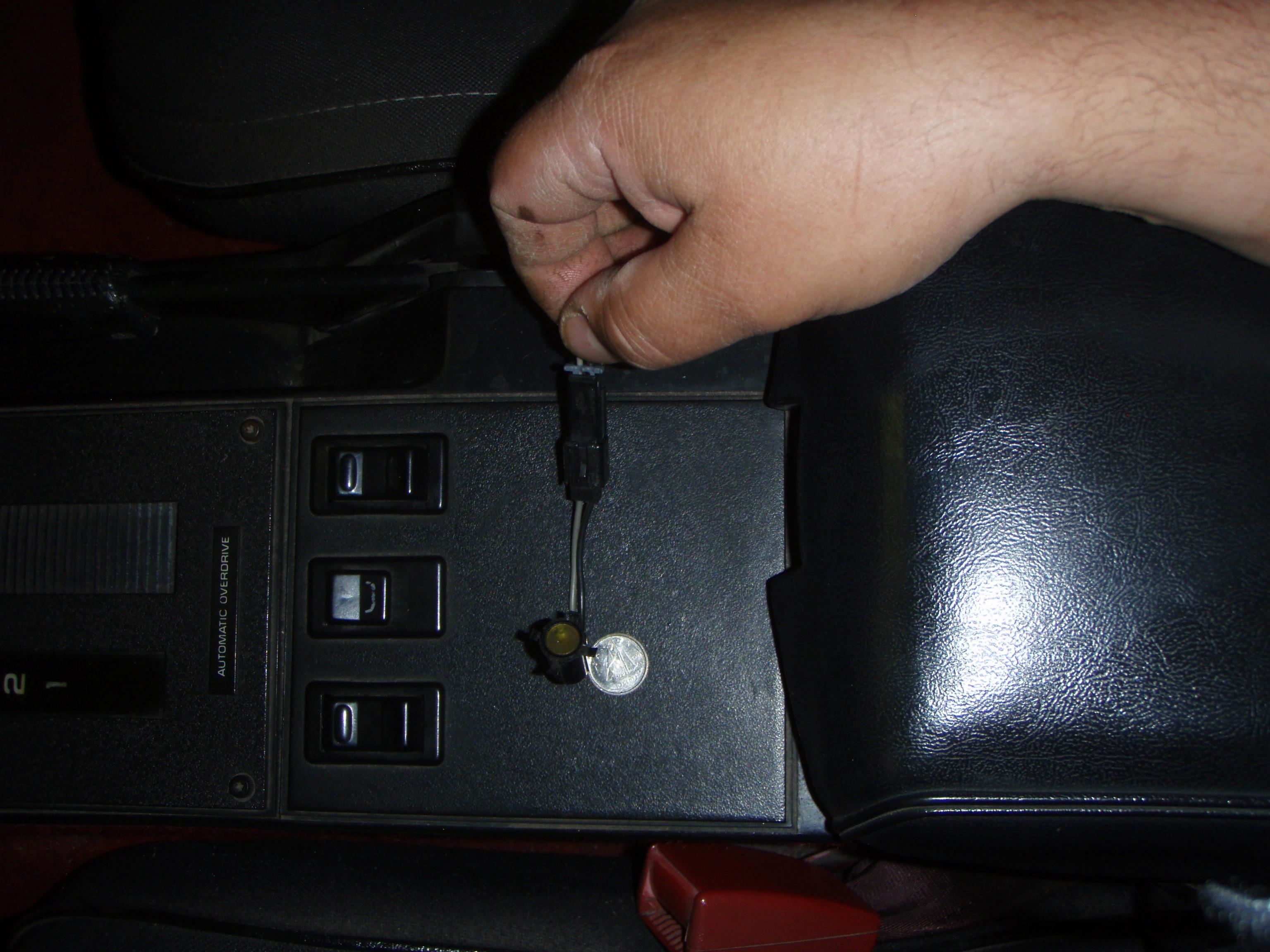

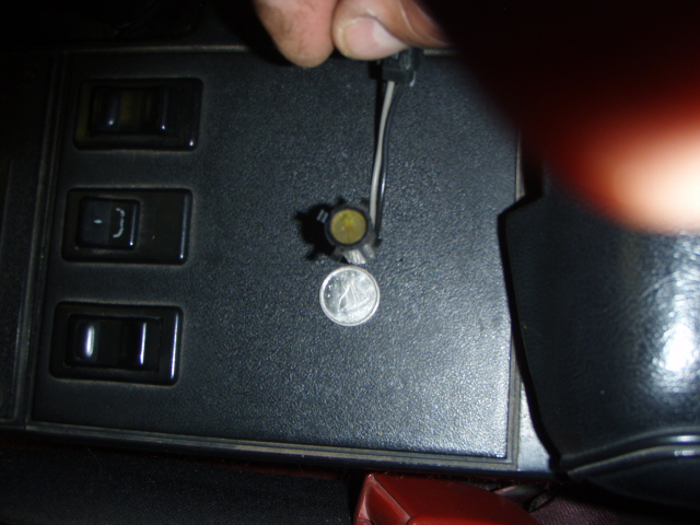

Originally Posted by WHITE88IROC
Here's a pic of the bulb... You can have mine. I replaced it with this. I can give you step by step and photos if you want. Its simple
These can stay on or goto beat of music. They can not dim, however being that they are fluorescent. Doesnt bother me, looks great! Much brighter in person, taken with a cellphone
wow very different than mine ,mine is a one piece unit see pics and size compared to the dime
Attached Thumbnails Empty Interior Light-ashtray-light-001.jpg   Empty Interior Light-ashtray-light-005.jpg   Empty Interior Light-ashtray-light-013.jpg

Re: Empty Interior Light
lol...good old GM. 17 different bulbs/configs, one car. As i said, use anything you want to, as long as its 12v and you're sure of polarities. F the GM parts unless you're going for Concours award winner stock!
