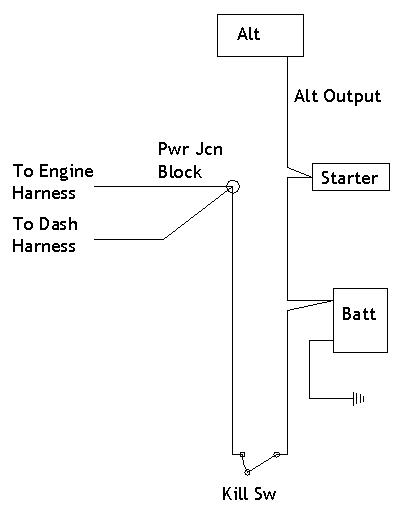

Is this correct/OK to do?
Ok first off I know there is tons of info about this topic on here, I have read alot of it. My problem is theres kill switch's and other things added to the diagrams and builds I have read and seen already, im an idiot. So I im sorry again for posting this question.
Secondly try not to make fun of my ugly, crude attempt at drawing something on the computer.
Third I dont want kill switch I want to keep it as simple as possible.
Attached Thumbnails Is this correct/OK to do?-battery-relocate-drawing.jpg

should there be a fuse/breaker between alt. and batt.?

Try this one. Only difference from this LS1 diagram to yours is your alt requires a 12v batt source. Pull it from the power dist block that feeds the engine/dash. That way your alt dies when the engine/dash are shut off
