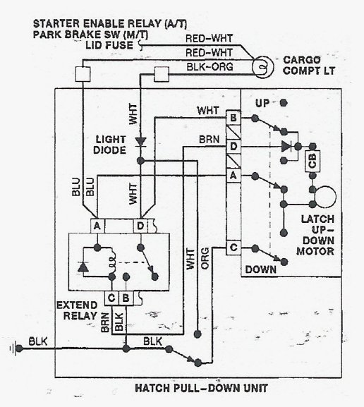

The unit has a black wire and a blue wire. I've tried hooking them up to the battery and I'm pushing the switch with a screwdriver to get it to go down and it isn't responding. Wasn't there something weird like the black is positive and blue is negative? If I remember reading correctly?
I also notice that the wiring diagrams I'm finding for the 88 - 92 Camaro's are different because of the hatch release (which mine doesn't have). I've attached a wiring diagram that I found here, this is the correct one for this year?

The hatch extend relay has to be in the circuit for it to work I think - that relay switches 12v from the "up" side to the "down" side of the motor (if that makes sense). If you have the unit out of the car, you won't get it to work, as that relay is still in the car.
