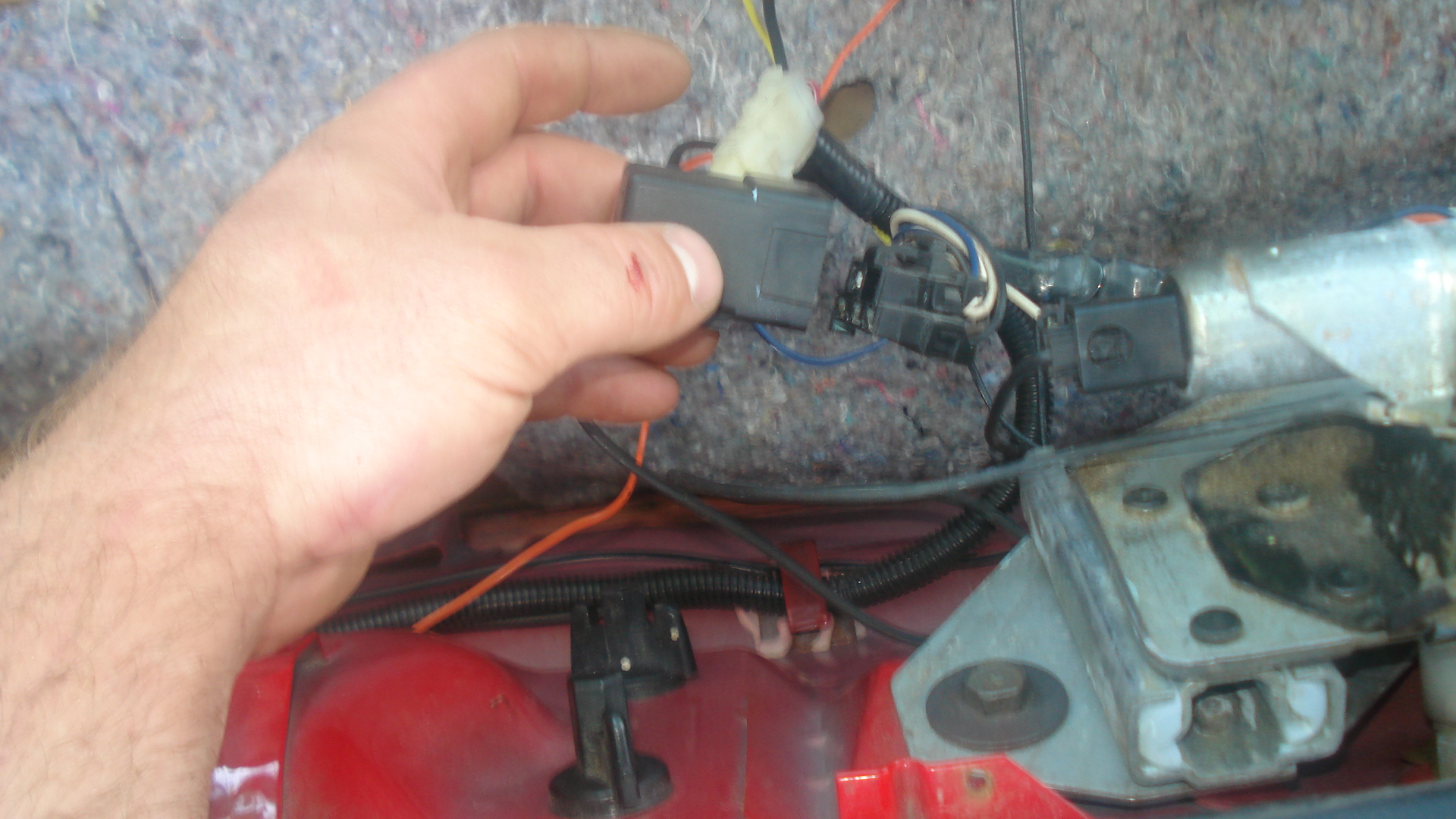

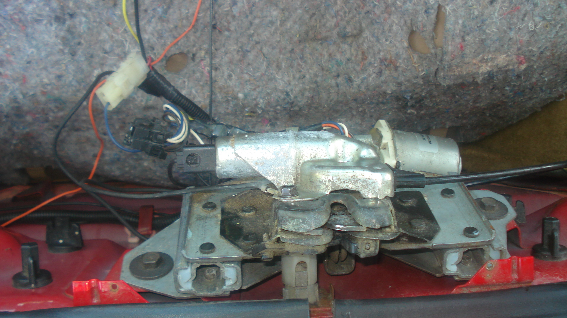

so i put it all back together tonight but i did snap some pics before hand
but not sure how to post them on here. other bad news is that i put my new computer in tonight too and now it runs even worse at idle (maybe a relearn issue ) but my ses light still doesn`t come on they way it should
so i think it might be the prom but at this point i am close to giving up abd take it to the shop and let them figure something out
i think i figured out how to upload pic lets see
Attached Thumbnails dead short somewhere?-hatch-top.jpg   dead short somewhere?-hatch-1.jpg   dead short somewhere?-relay-1.jpg

I THINK I GOT THE SHORT ISSUE SOLVED, I BELIEVE IT WAS THE HATCH MOTOR NOT REACHING THE BOTTOM OF THE STROKE AND TURNING OFF, IF I LEAN ON THE HATCH IT WILL GO DOWN ALL THE WAY AND CLICK THE REVERSE SWITCH WHICH SHUTS IT OFF, I HAVE HAD NO DEAD BATTERY ISSUES SINCE. I WILL SEE IF I CAN ADJUST THE MOTOR UP A BIT SO IT DOES HAVE TO PULL IT DOWN SO HARD
Old Jun 20, 2011 | 08:24 AM
TreeFiddy's Avatar
Joined: Jun 2005
Posts: 1,380
From: Sydney, Australia
Car: '86 TA
Engine: '74 350
Axle/Gears: 2.77
Re: dead short somewhere?
You haven't by any chance removed your rear spoiler, and also put in new hatch struts? I have, and the poor old hatch motor just doesn't have the power to close the hatch against the pull from the struts, without the weight of the spoiler to help.
It will just stall like it sounds yours is doing, and continue to draw current until either a fuse pops or the battery is flat. Though I never let it get that far, can't be good for the motor.
Like you, I just lean on the hatch till it clicks. This will be fixed if I ever get around to replacing the spoiler.

nope, never removed the spoiler or replaced the struts, i just installed another (not original) hatch pull down motor. when i bought the car the original was removed

Yeah long shot. Like you said, sounds like the motor's not quite adjusted to the right position.
