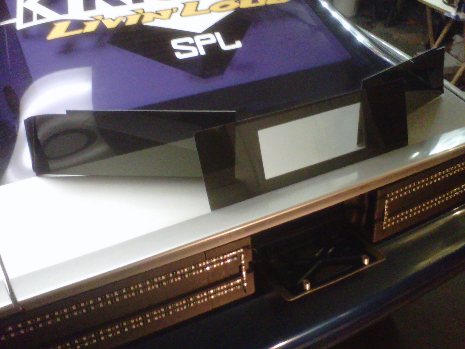

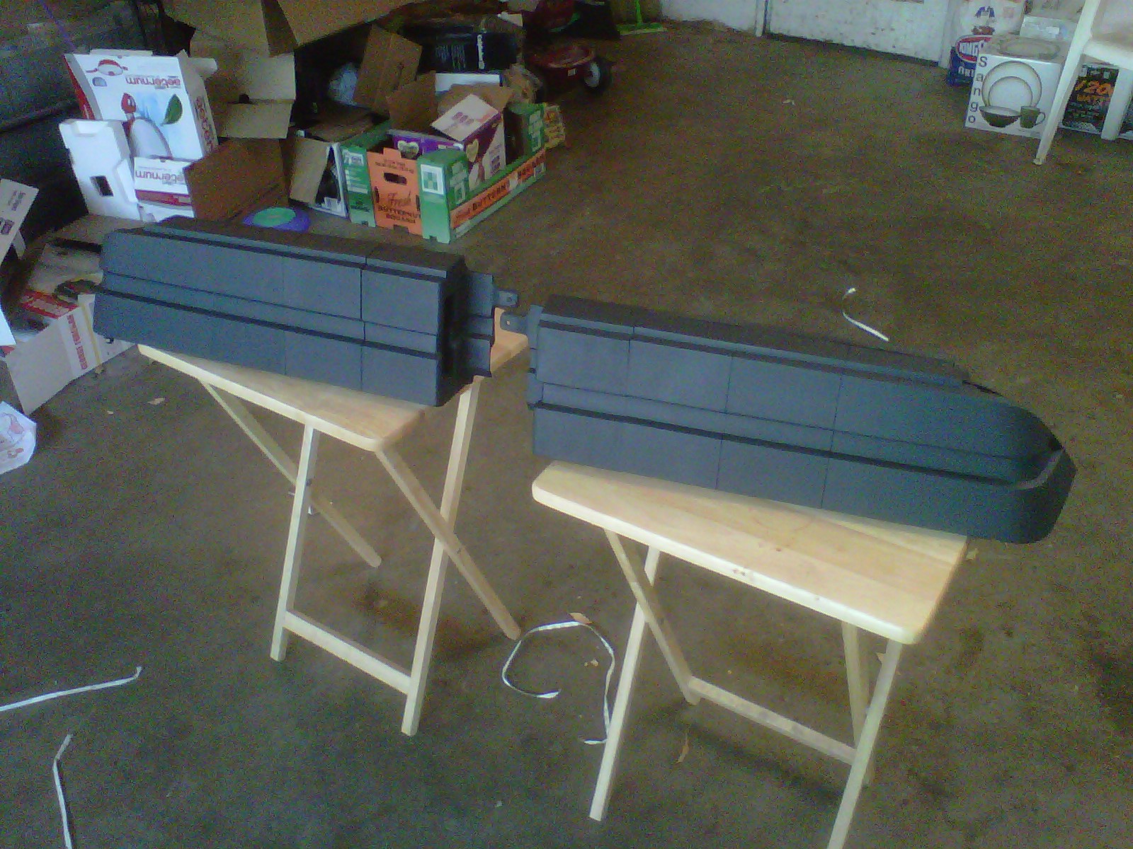

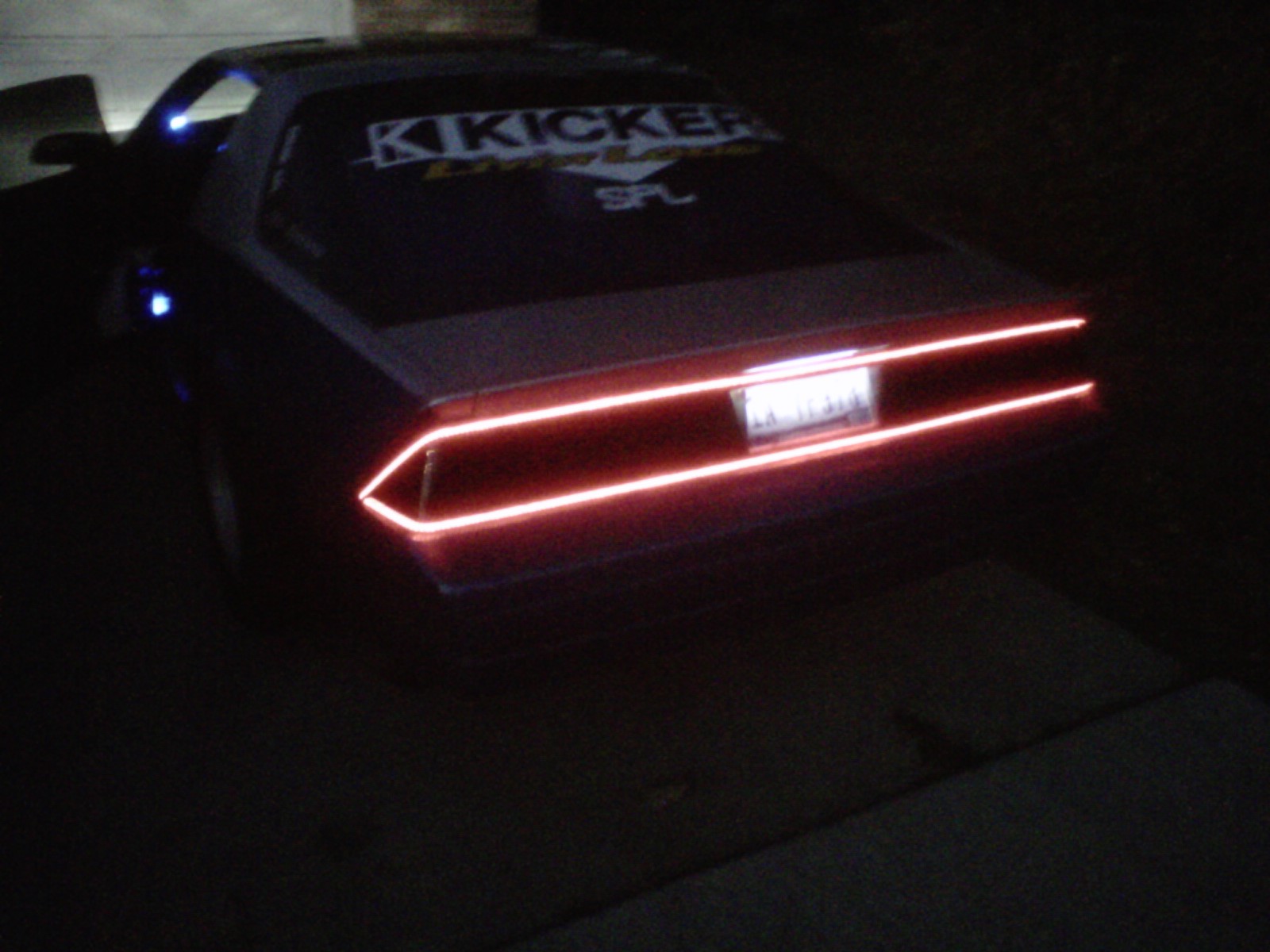

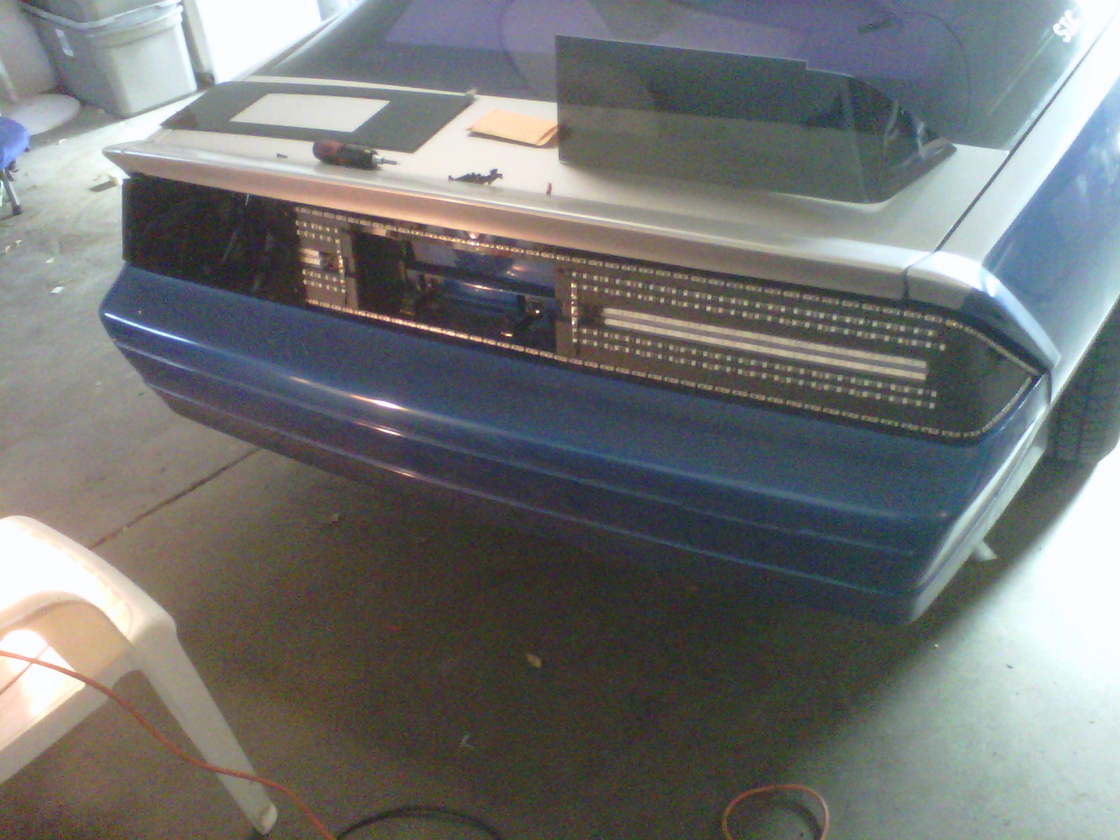

I built mine under smoked plexi that goes all the way across with a clear plexi window, white led lit and tilted plate. 3 times brighter led for brake and mellow amber for turn. not lit in photo. If interested I will take more pix and post them.
All bulbs throughout car are now led except the H4 halo headlight conversion. Also I fabbed the new smoked clear turn lights up front into 55w H4 driving lights and added small smoked led turn signals into the bumper between the grill opening and the now driving lights.
Attachment 252500
Attachment 252501
I'd like to see some more pictures!
some more. Couldnd catch the turns in the pic. Sorry they arent best quality cuz ther are from my phone. Need to get a good camera. When the weather clears and I clean up I will post some day shots of the nose and tail unless no one cares about snow dirt.
Attachment 252500
Attachment 252501

I built the setup using the older split taillights, 1/8" smoked plexi and two styles of led strip found in rolls on ebay( 3528 5m black pcb 600led red ) and ( 5050 5m black pcb 300led red ) the 3528 is the wrap around and the 5050 is the brakes. Sand down the lenses and black primer them, make a paper stensil for the side pieces to cut the plexi,( pop displays on ebay has grips of plexi and lexan in sheets of all sizes and does free cuts) fab bridges across the LP span, use a piece of clear for the LP, use a heat gun to curve the ends, drill the plexi and lense to use stainless fine thread allen screws (round top) from hardware store. Connect 3528 to park lights, 5050 to brake lights and use a 50w led resistor(ebay) for each rear turn tapped into the loom in the hatch.
If any one wants to do this I am more than willing to share info and advice or more detailed steps.
