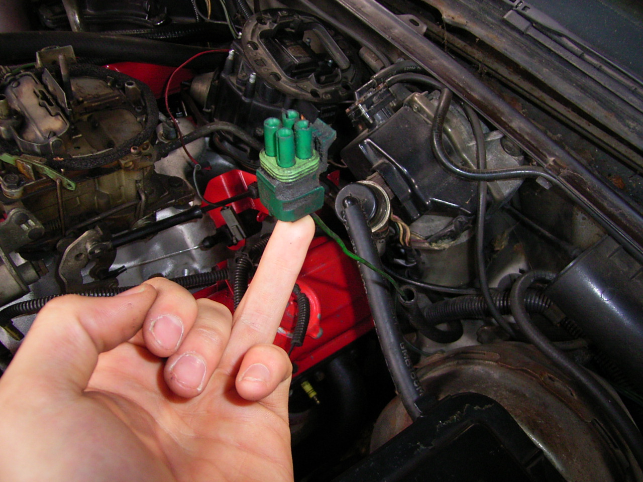

Hello,
I have one single plug near the master brake cylinder. And I have absolutely no clue where to put it.
Maybe anyone knows where it belongs too.
Thanks a lot.

looks like a plug that goes into the tranny of a auto car but I might be wrong. I cant remember what it does off hand but I think its either torque converter lock up or your reverse lights.

Thx, I'll give it a try and get underneath the car tomorrow. I was always lookin' in the engine compartment.

If the car had "export" emissions that would have been for the TCC on the original TH200C transmission. If you have a TH350 now there's nowhere to plug it in.
