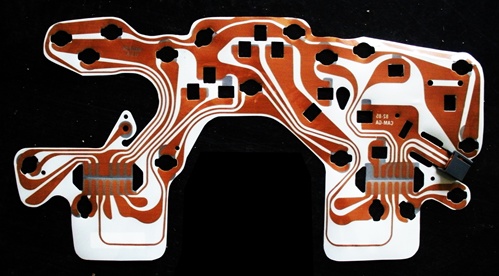

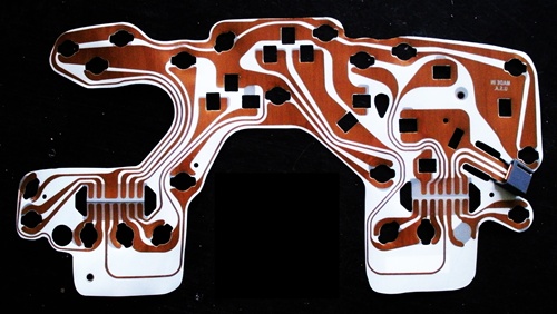

What are the differences between a 1985 and 1986 Dash Printed Circuit Board?
I put an 85 cluster in my 86 Iroc-Z so I could have the 145mph gauge and one light is constantly on.
I noticed while looking at the PCB on an 85 and on an 86 there are differences and I am wondering if this could be my problem since the light that stays on doesn't appear to be in the circuit on an 86.
Attached are the pictures of the 85 PCB and 86 PCB.
The light that is always on is the bottom right one that is gray on the 86 PCB.

After taking apart my whole console I found that I was operating an 85 PCB with an 86 cluster.
If anyone out there has the 86 PCB for sale, or knows where I can get one as pictured above it would be appreciated. Thanks.
