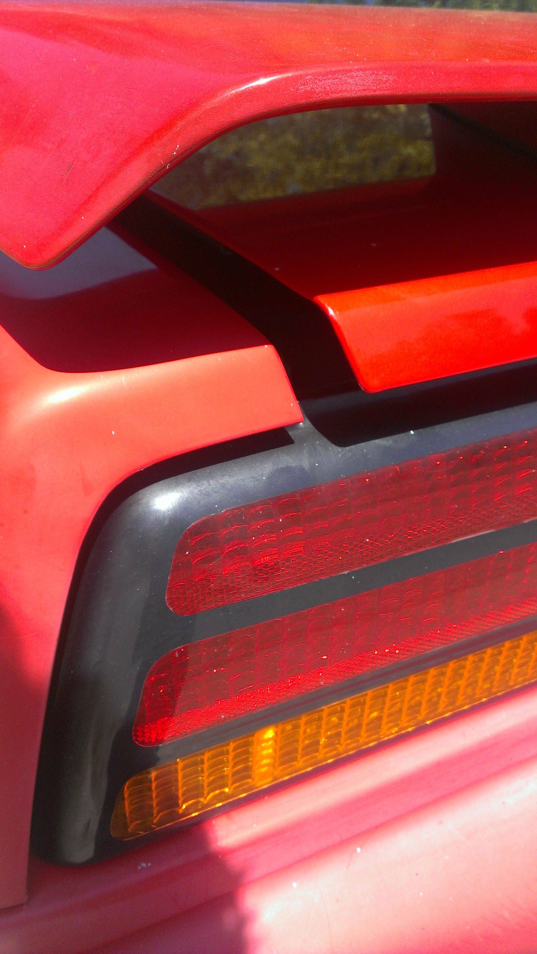

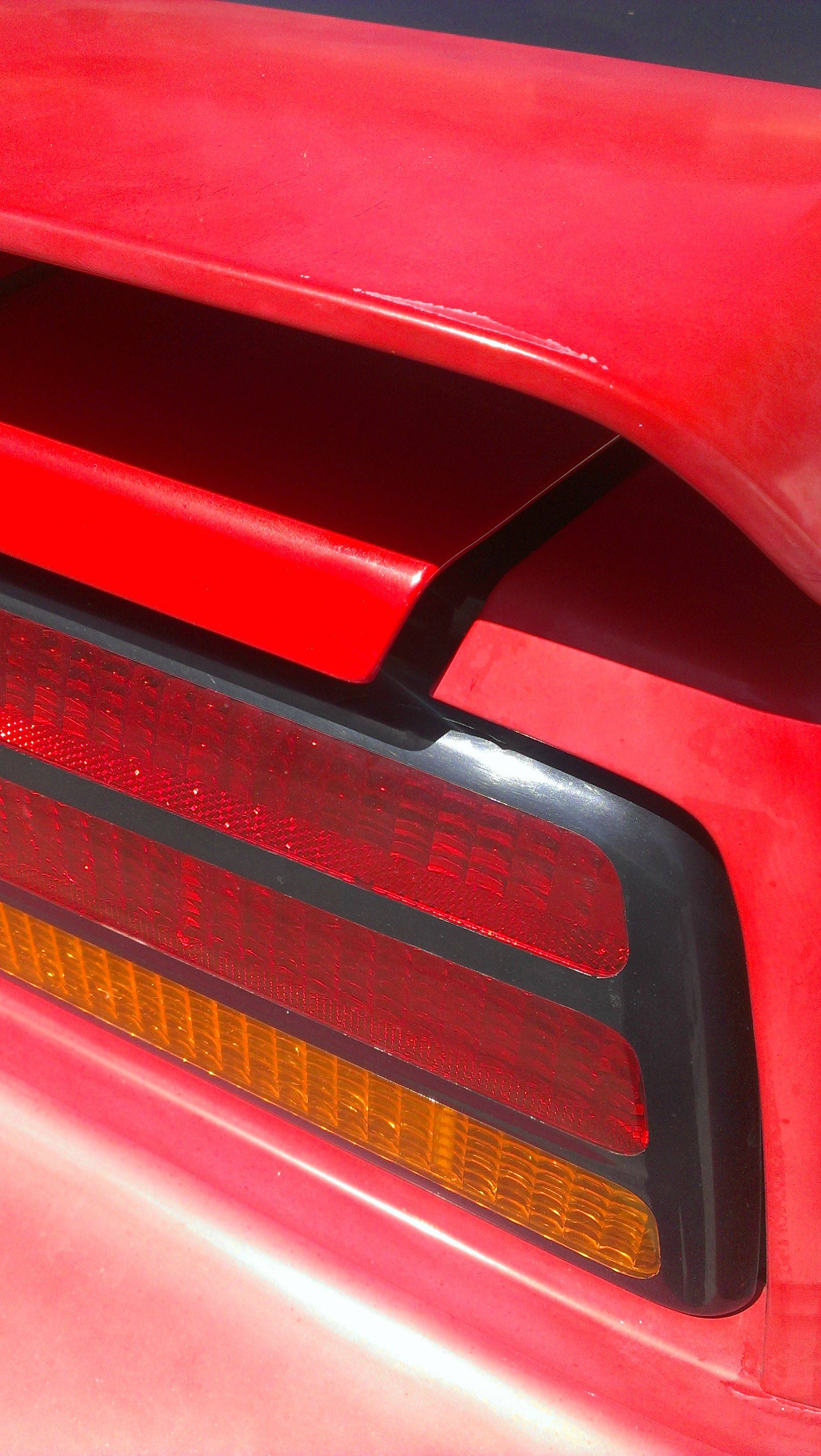

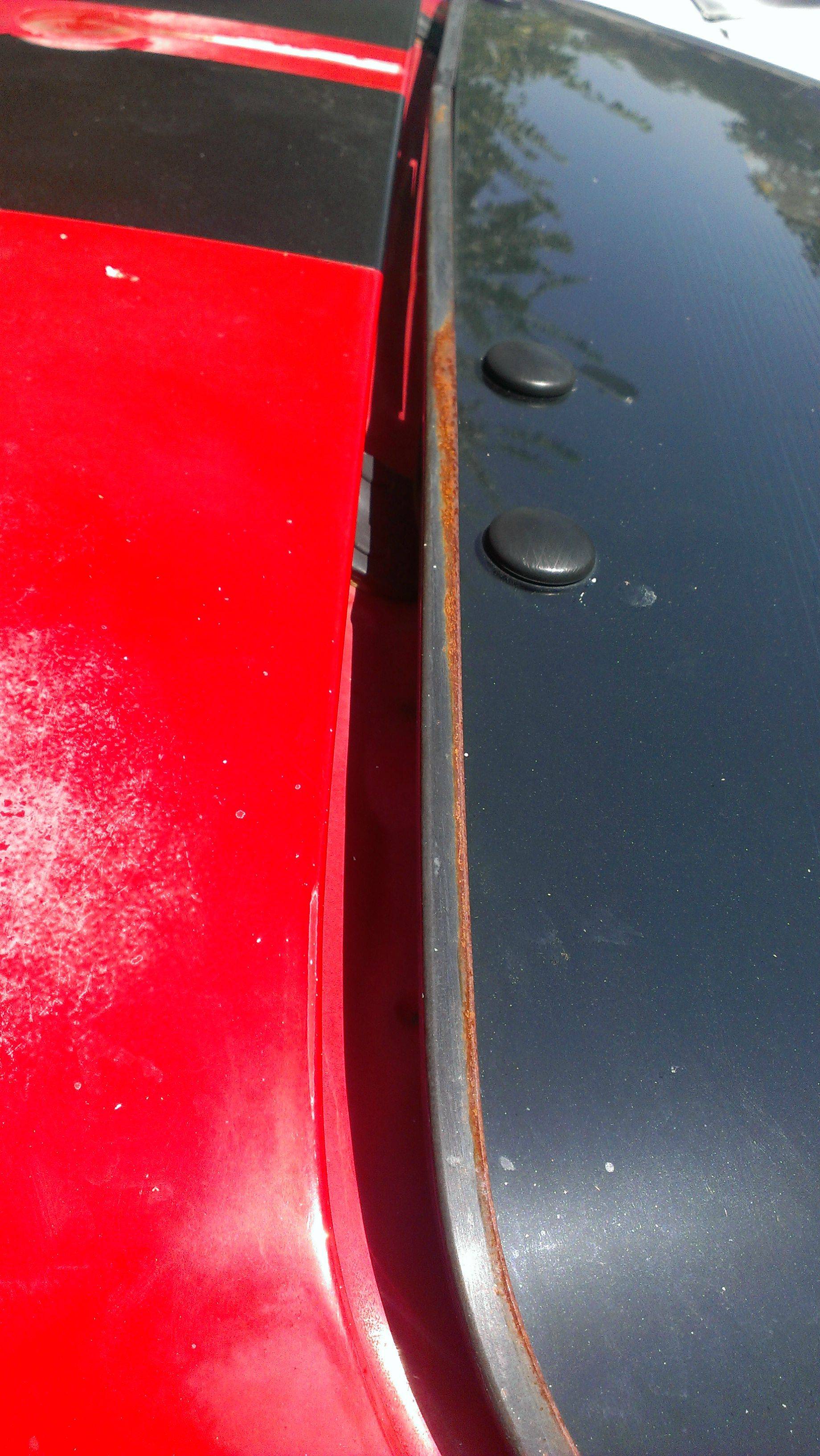

I removed the trunk latch and motor this weekend. Even with nothing to stop it from going down, the hatch still wouldn't go down anymore. Would this mean I need to realign my hatch, or should I replace the motor first? I reattached the latch, because I could not figure out what was wrong. Rain doesn't get in, but the hatch rattles when I drive.
I have attached some photos, to show how much it sticks up and out.
the Driver's side seems to stick up and out a bit farther.

Old Aug 6, 2013 | 06:07 PM
Base91's Avatar
Joined: Sep 2010
Posts: 1,928
From: Georgetown TX
Car: Base 91 'bird
Engine: 3.1 v6
Transmission: 4L60
Axle/Gears: 9-bolt 3.27 & PBR
Re: 91' Firebird Trunk Pull Down Motor. Need Help
The hatch needs to be aligned.

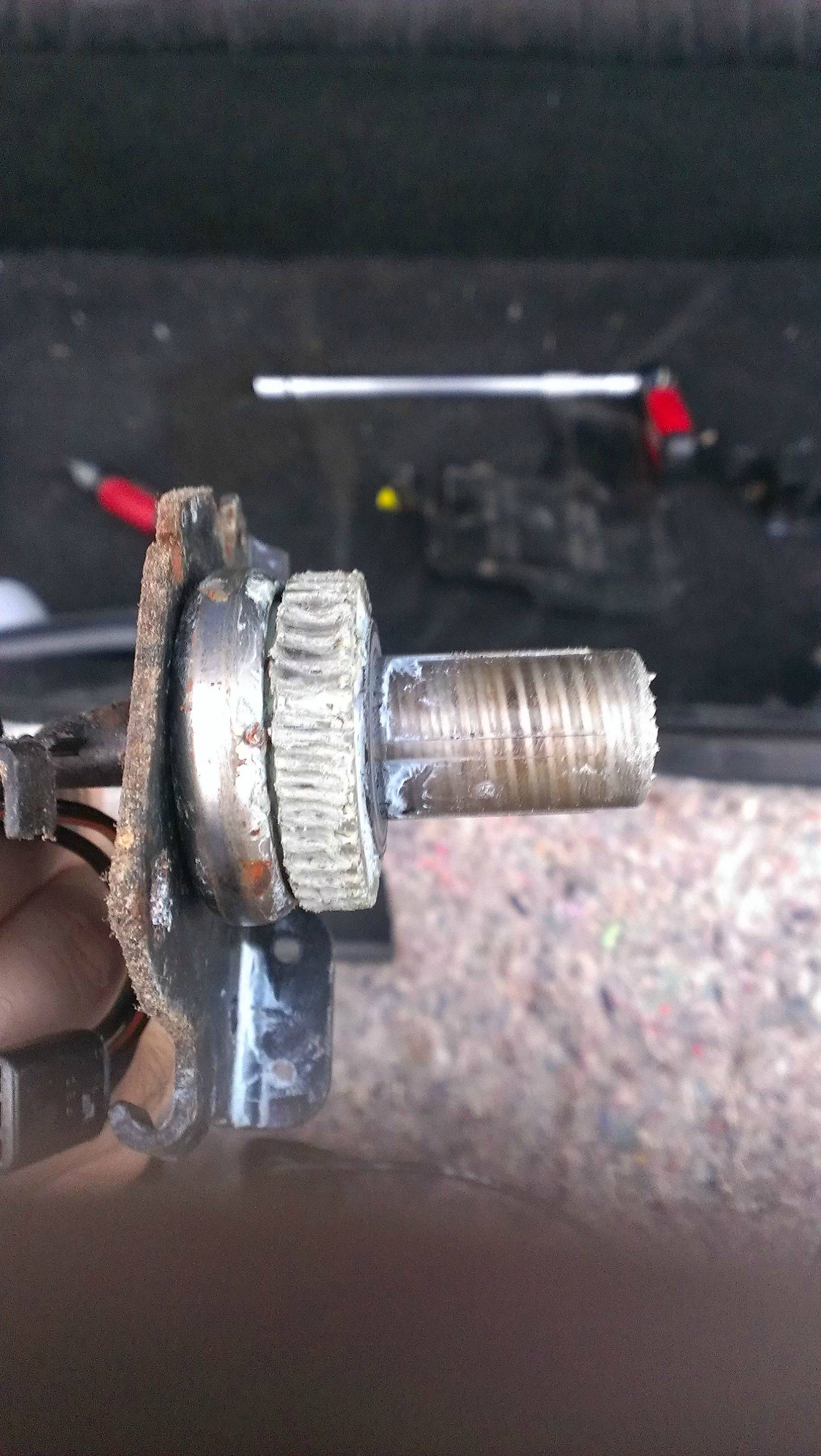

I just took apart the whole thing. The motor seems to be good(saw it spin), and the bushings are good. The Gear Nut that attaches to the motor looked like it might be stripped. I found that TDS sells them for $8, so I might order one. I'll take a better look at it tomorrow when I take it back off.

The pictures were with the motor removed correct? Then yes the hatch is out of alignment. I wish I could tell you how to do that but im guessing it cant be that difficult to adjust the hinges. Cant make it too much worse

The pictures were with the hatch latched, and nothing removed. How much does the hatch stick up and out before the motor engages? I don't want to over align it.

It's not even close. No wonder the gears stripped trying to pull the hatch into position. The gap around the hatch should be even and it should sit flush with the fender and the back end of the car. The motor should only need to pull it down the last 1/2 inch or so but the hatch has to be all square. It looks like the left hand hinge is loose. It's certainly way out of position.
