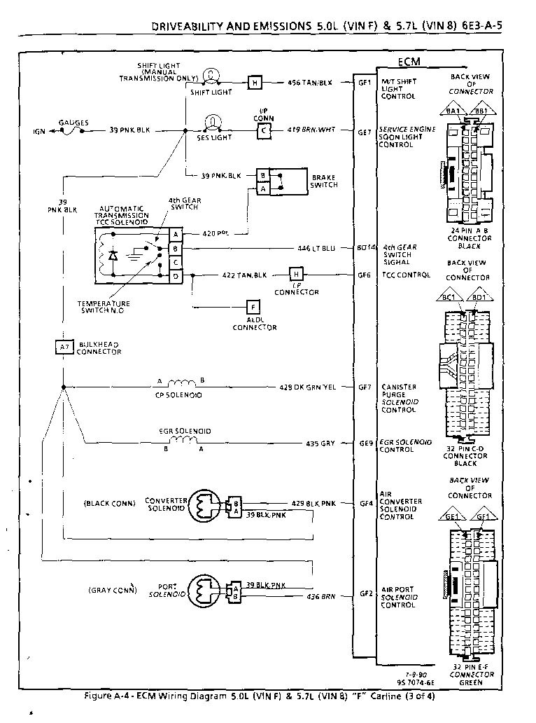

ok look i got a SD harness on here that was for manual and not my auto
can i add the 700r4 lockup and speed sensor and how would i go about it

just guessing was your car tbi before ? You can stip the wiring off your old harness. tcc lockup consists of three wires to the transmission for tcc. from ecm and 4th gear switch. The brake switch goes through c100

yea it was tbi i was making sure i dont need to repin anything i know i got a ecm and prom from you and i still need to repin some brown wires for the speedo to work taxes time is comings so sould be able to get it ready to ride

You wouldn't use the wires that are on the sd harness for the vss going directly to the ecm but instead the tbi wires that go through c100 to the vss buffer. You can un pin b9 and b10 those would not be used but the vss input would go from the buffer to c6 and the output to the speedometer is b11

and ill find these where the dash harness plugs to the SD harness right

All the changes I listed will be made at the ecm. You will want to check for differences at c100 and c201.
