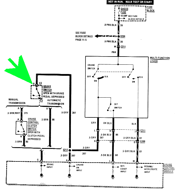

87 iroc could someone please tell me what are the colors of the 2 wires that connect to the brake light switch not the 3 on the top the 2 on the side . an any pic. what the plug looks like Thanks.

Presumably, you are asking about the cruise control wiring on the brake switch... ?
