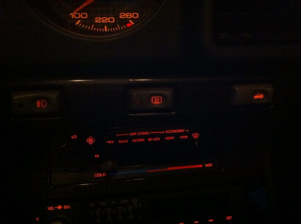

I finally found a set of fog lights for a 91-92 car at a junkyard, everything was there so I got it, switch panel, lights, etc. Anyway, after searching through some threads on here, I learned that the plug on the interior does indeed exist for the switch. Opened the switch panel on my Formula up when I got home, yup, plug was tucked away and covered with dried up tape from 1992, cool!
My question is, what should I go back and pull off the donor car? The entire wiring harness? I take it I need a relay of some sort, though I have no idea where it's mounted, and from what I've read here, it seems that the underhood portion of wiring doesn't exist. At what point/location do I have to go back and either start hacking or splicing? Does the wiring go to the fuse box at least? I want it to appear as stock as possible.
I thought it was interesting that when I hooked up the new foglight switch, power was already available for the backlighting- it lit up when I turned on the parking lights!
