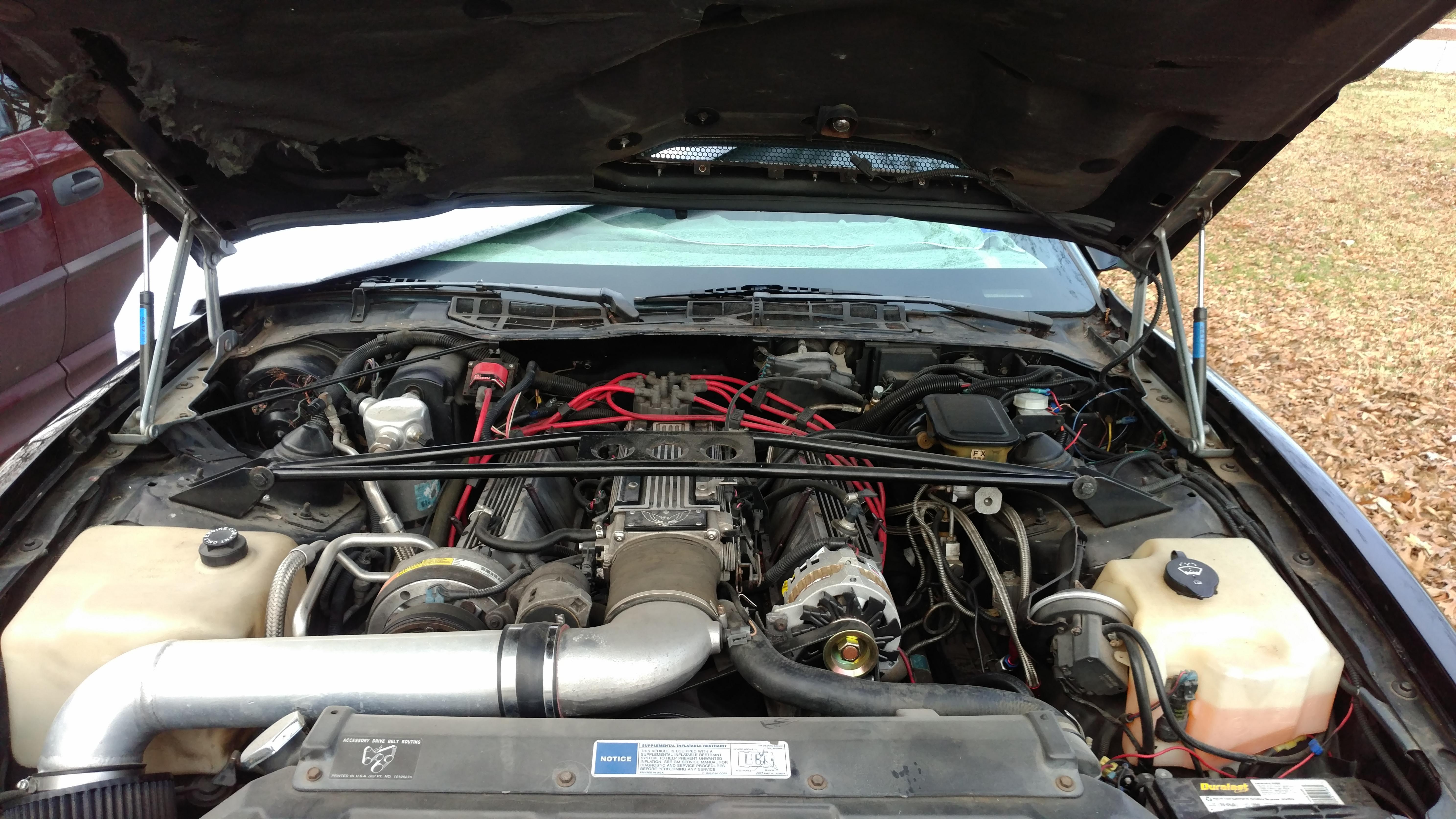

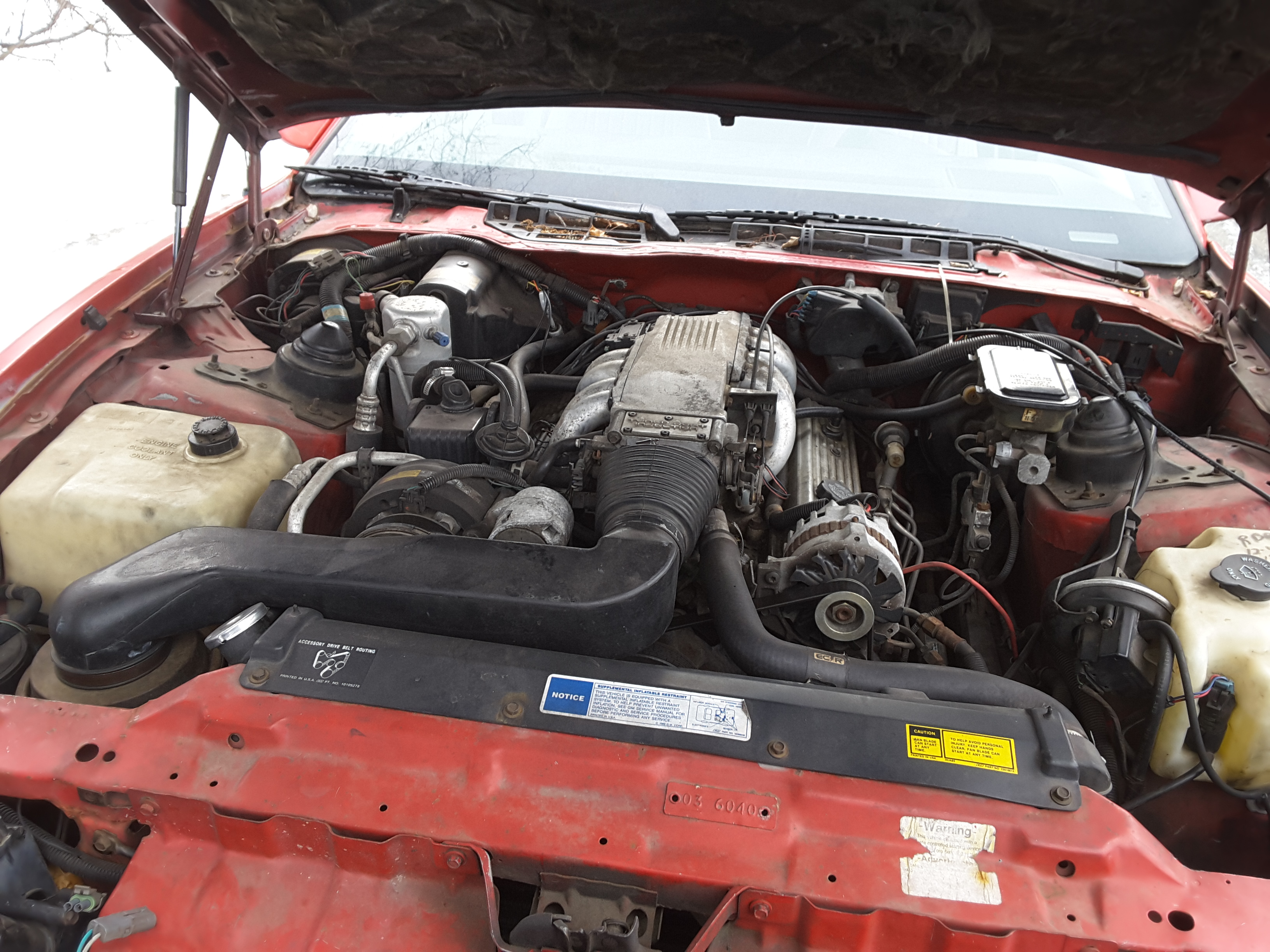

I may have a line on a harness from a 91 GTA and want to make sure I shouldn't have issues or missing components. I've seen engine bay photos of a TA before and it had less wiring passing over the left tire hump then we have on our Formy (and also a 92 Formy) so I want to make sure I pay for something I can actually plug in and use and not have to modify to hell.
First pic below is the 91 TA second is the 92 Formy (both taken from the forum here of other members cars) The third is ours as you can tell there is more wiring on the Formula's then the TA. Heck the TA only has the hood pop cable from what I can tell.

The engine harness will be the same for the same setups. Lights are in a different harness
You are seeing a difference and that Is from incorrectly routed things, added on aftermarket things and some deleted factory things (wiring and vac tubing).
If anything the GTA should have a couple more wires for the fog lights.
