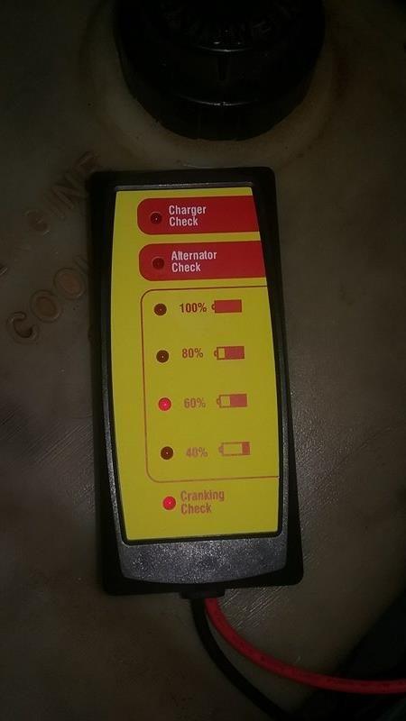

EDIT: Got a battery tester/starter tester/alternator tester (those will only work if it cranks lol) at walmart for like 9 bucks and it says my charge level is only 60%....bought a multimeter, need to read how to use it, all these symbols and **** confuse me badly tbh...lol, I didn't do so well back years ago in school in science class to be honest........

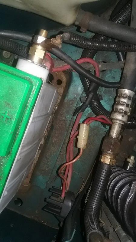

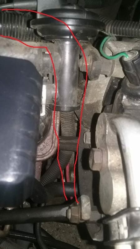

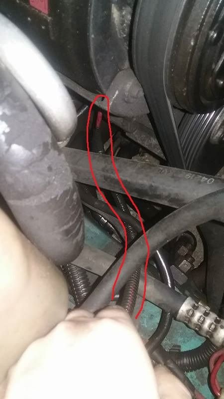

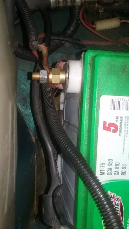

I have a side post battery with TWO red wires on the positive though, I can attach pics.....one "main" big one goes sorta by the radiator then the other skinny small one goes behind the AC compressor then dissappears into a big huge wiring harness that looks stock....I've never had a vehicle like this though with two that I know of.
Once I figure out this multimeter I'll be able to tell if there's a parasitic draw, or if this 3 month old interstate sucked and died...lol
edit2: battery tested ok and they charged it but yet the car still won't start....just sits there turning over real heavy/slow
