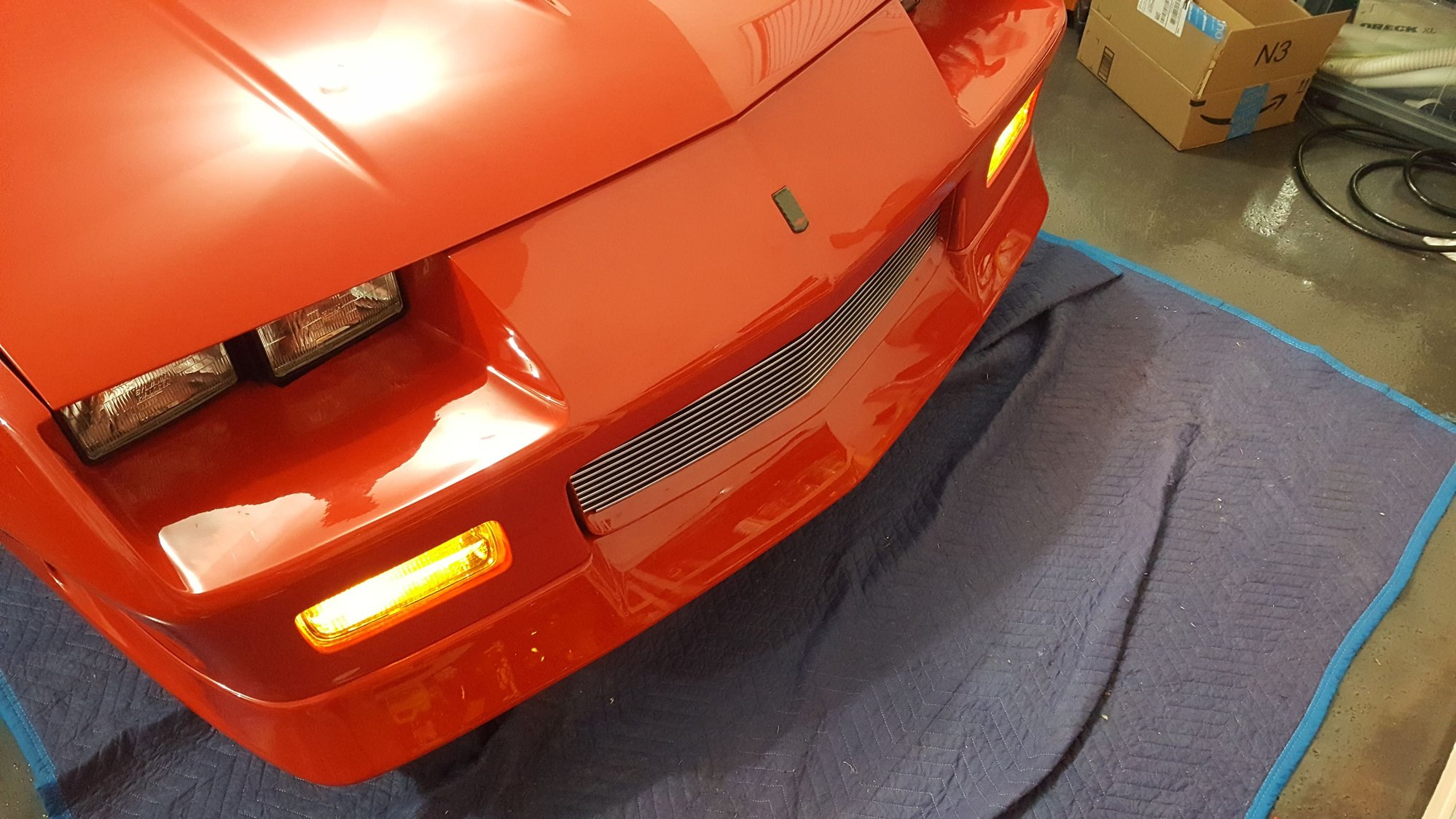

On the front bumper turn signals, can someone confirm the brown is the running light, blue is the turn signal, and black is the ground? Adding load resistors and need to make sure I am bridging the right ones

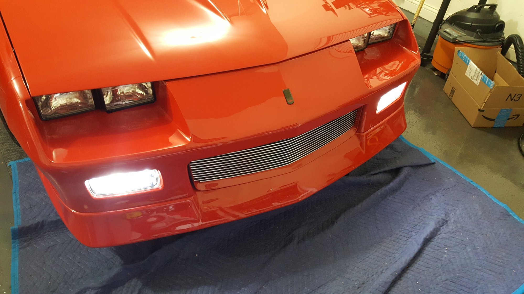

I got it. Blue is the turn signal flash, black is the ground. I put flip flop lights in. Looks pretty awesome I think.
