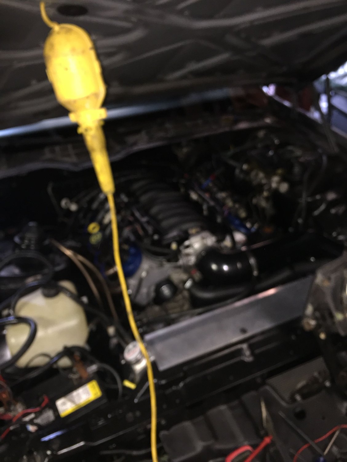

Re: Hello everyone...
Here is a few I have. Hope I did this right haha Thanks for the welcoming!ok gonna order a new motor, and see what happens.
