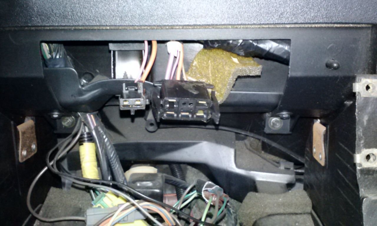

Here are a couple of connectors I found unplugged above the HAVC control. Any ideas on these? Maybe for other optioned cars?

The larger plug looks like a rear defroster plug,... the smaller one is Full time power ( Orange ) and Accessory power (Pink) for other additional options; might be power windows, power antenna or something like that.
Thanks John. I need an aux power that I was going to tap into the fuse panel for and I will just use that pink wire.
