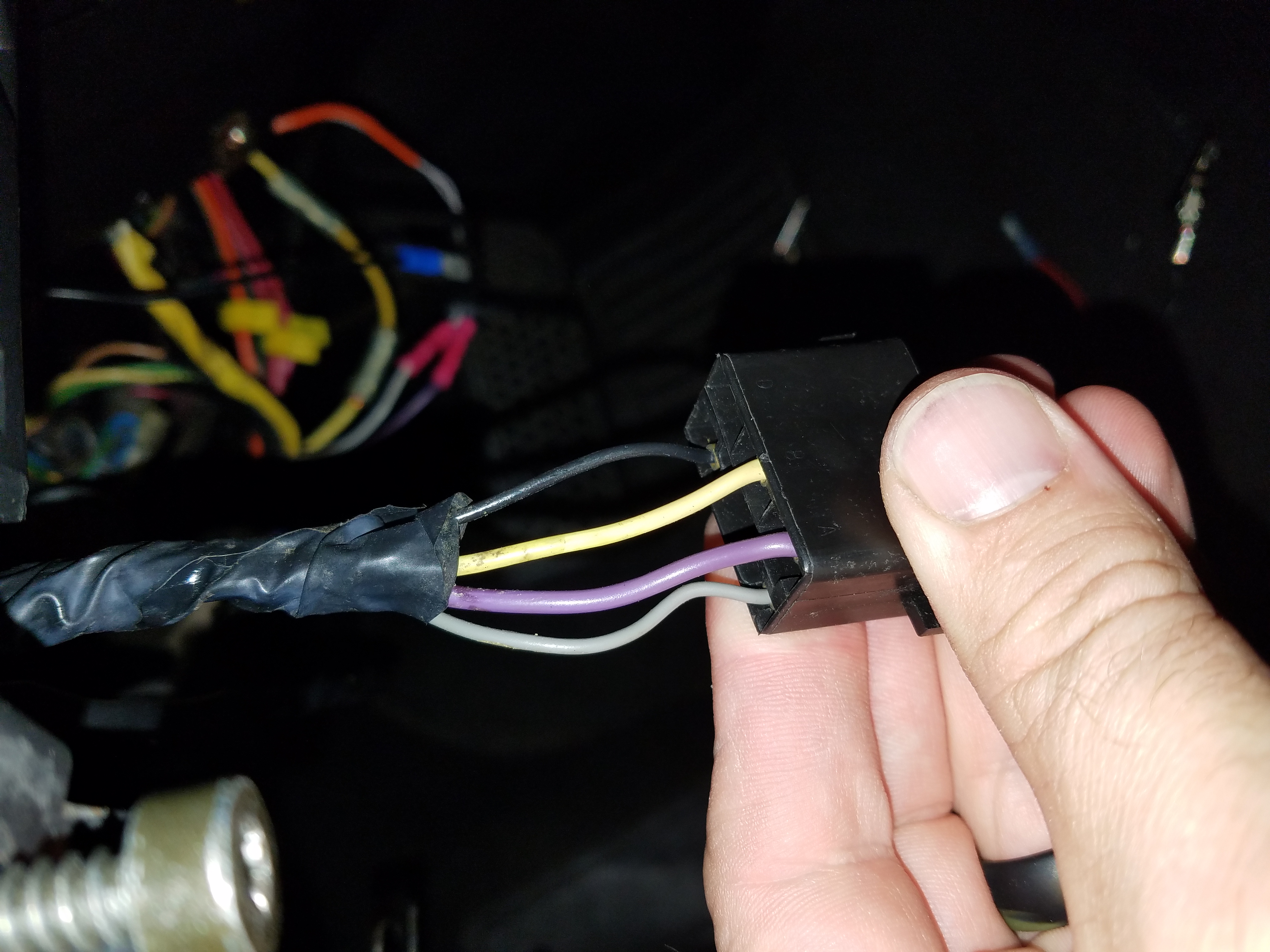

I've got no dash lights (except high beam indicator does work) or warning lights like SES, seatbelt, etc. on the dash when turning key to on. Everything else seems to work, fuel pump primes, all exterior lights work, and starter will kick over. It's not ready to run yet so didn't try to actually start it. I've been undoing bubba's work under the dash and found this plug that looks to be coming from the back of the gauge panel so thinking this is the problem. Can someone help identify it and tell me where it should go. Wire colors are Grey, Purple, Yellow, and Black. Looking at a wiring diagram these look to be going to "Switch Illum. Lamp" and "IND. Lamp" but I don't know where it should be plugged into and can't see anywhere obvious.
Thanks for any/all input.

Nevermind. Found it after googling images for a couple hours. It's the fog light switch plug. I don't have fog lights anymore so must not be my problem...

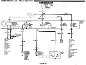

Originally Posted by SARswmr
Anyone tell me what powers the gauge cluster? Turn indicators and high beam indicator work but nothing else... assuming it's got to be the power source....
Did you check the 10 amp fuse marked "gauges" in the fusebox ?
Attached Thumbnails Help identify plug under dash-diagram_1989_gauges_part1.gif
