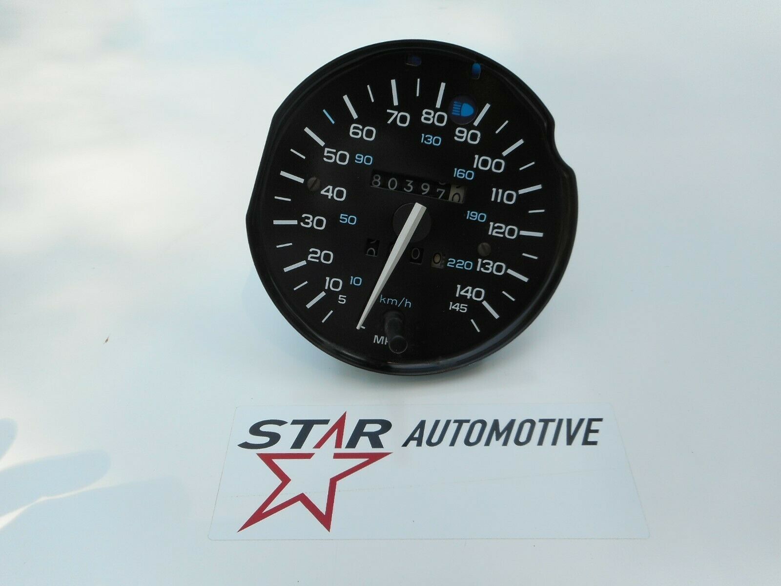

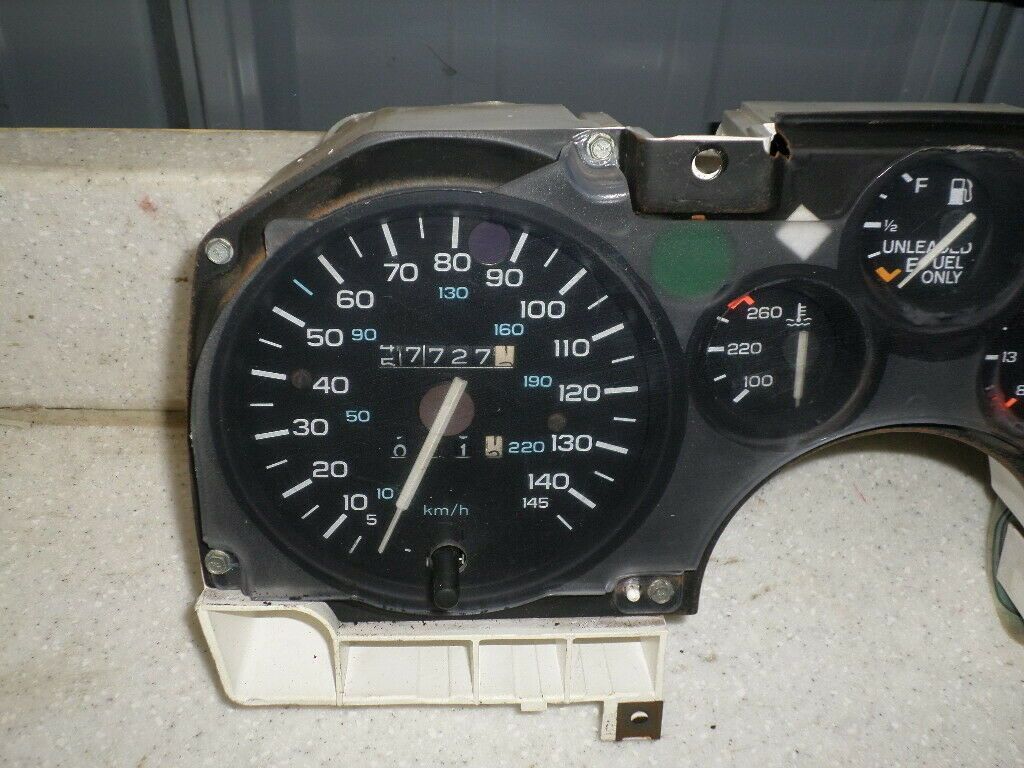

I went on eBay to look at other speedos, and noticed something. The needles are all sitting at a different position than mine. Does anyone know what the true position the needle is supposed to sit at? I've asked a buddy for a photo of his as well. Thoughts? Bueller? Is that white dash meant as the place it's supposed to be?
