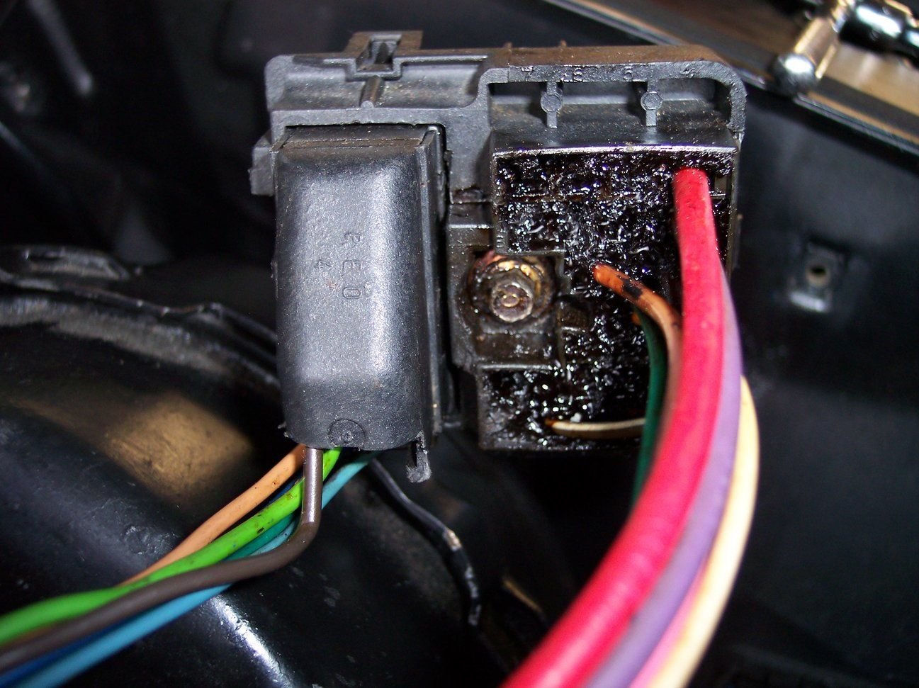

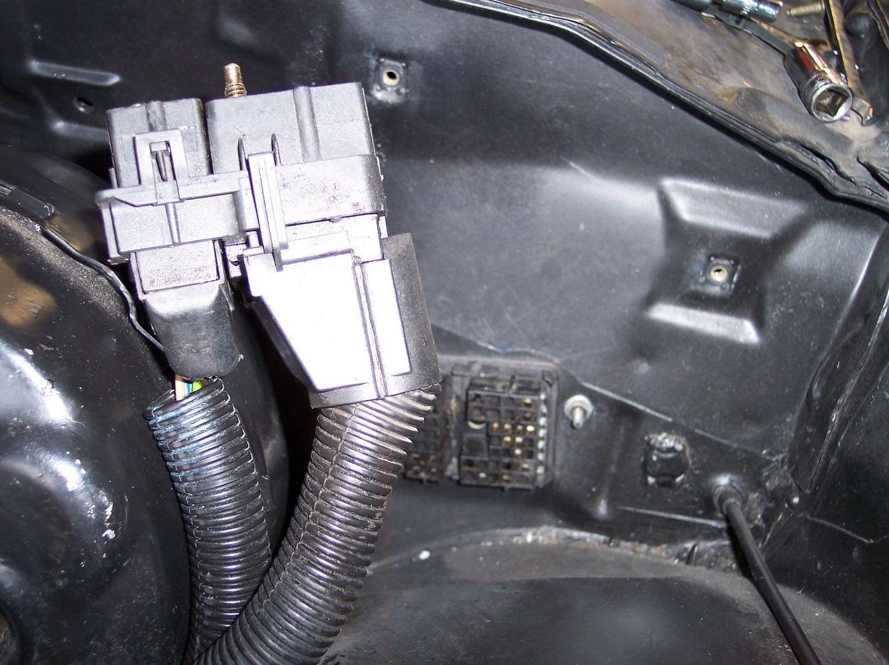

You can most likely make your own power distribution off of the battery under the hood...
Then use a 30A to 50A relay that is triggered by the ignition circuit turning on.
Find an unused/ blank terminal location in the fire-wall bulk-head connector (C100 Connector)...
Then pass the wire through the fire-wall bulk-head, by adding a terminal to each side of the C100 connector.
