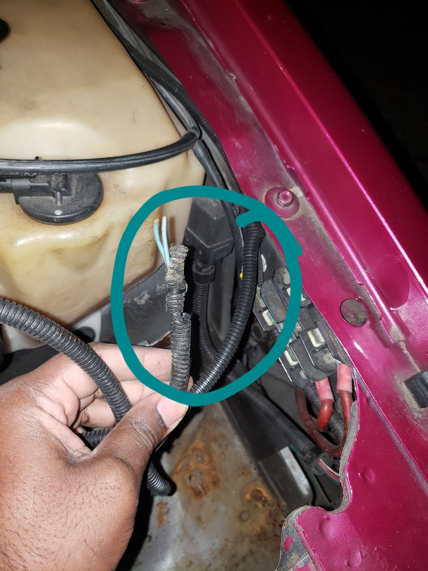

These 2 blue wires come from inside the car and go to battery area. What are they for?

Are the front turn signals connected and working? The left front gets a light blue wire, and the right front gets a dark blue wire.

Your right, it's for the turn signals. I never had checked them since I bought the car lol
