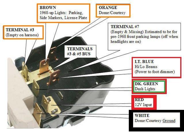

I am rewiring my car, and was wondering if anyone had the pinouts for the headlight switch terminals for a 91 rs.
​​​​​​This is one from a first gen, but I was wondering if anyone had one like this for our cars. Thanks!
