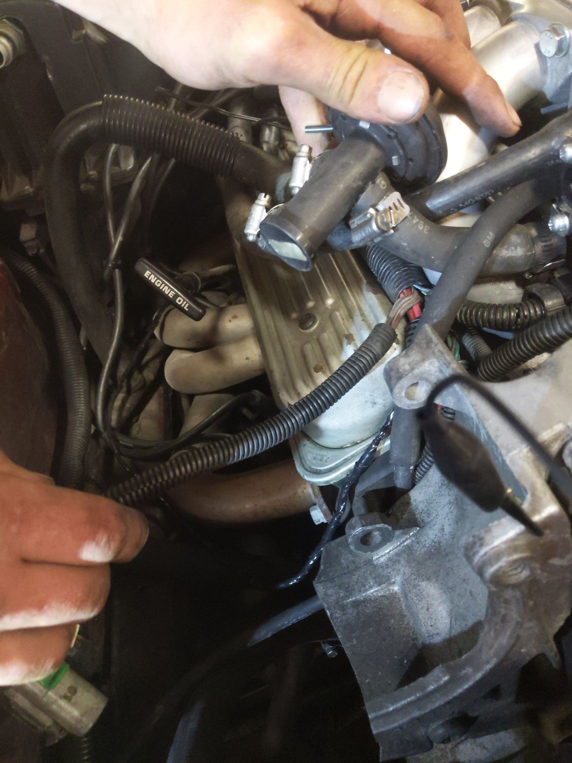

Hey guys, I have an 89 trans am GTA with a 350 TPI. We have been fixing up some wiring issues and I have no idea what these are for any help would be great!

give us a few more photos. can't really tell. they almost look like vacuum actuators that would control the canister, but my 90 definitely doesn't have that. they are also not routed like a 90 IIRC

Air pump diverter valve

What Tuned posted, AIR system control solenoids.

Yup,. looks like the partial remains of a disintegrated AIR diverter valve. Not the whole thing, just the electrical parts of it.

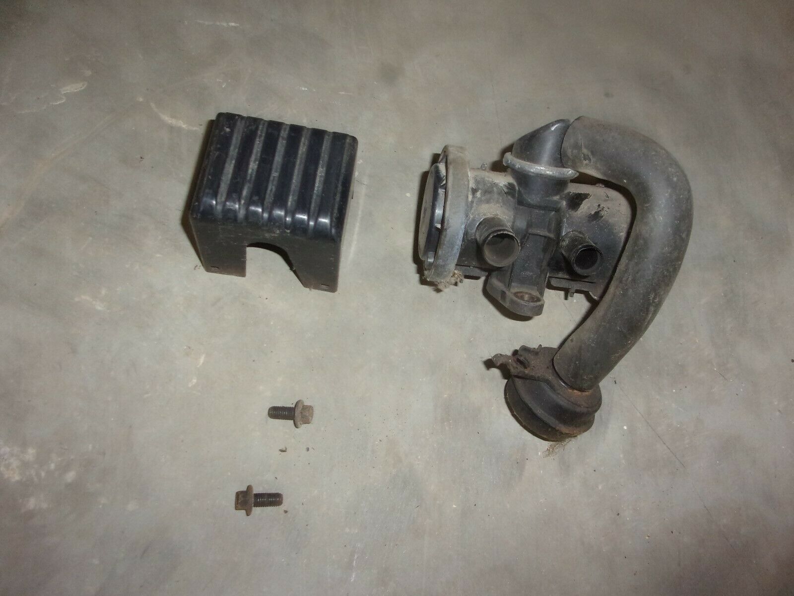

Yep, should plug into this:
