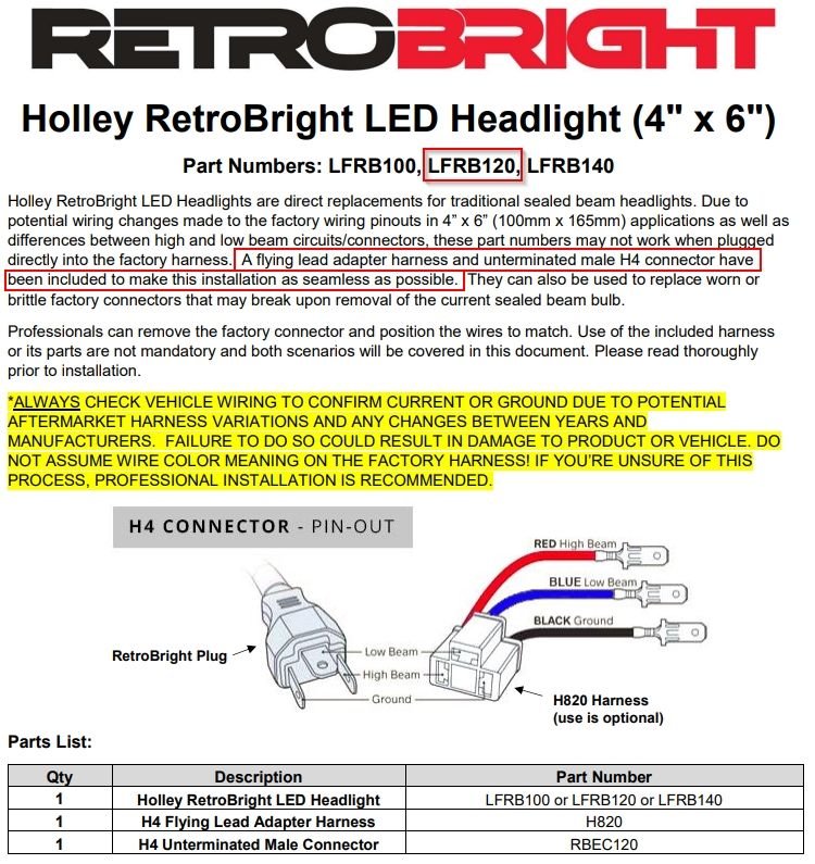

Also noted for Camaro's they have a cable that enables you to use 4 low and 4 high instead of 2 low / 2 high....

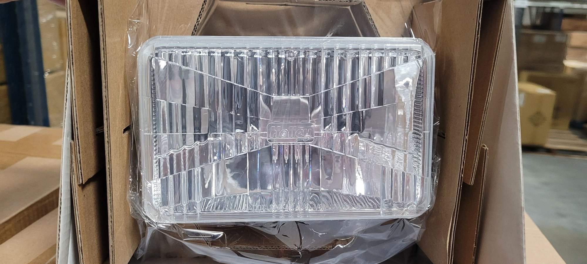

Whats wrong with the Glass Lamps from Hella?
They look stock, and will fit any Standard, HID, or LED that fits H1 or H4 Housings.
I have been using these for almost 20 Years.
Now I use them with H1 or H4 Adapters for HB3 and HB4 Bulbs...

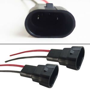

New HB3 or HB4 Bulb style, and sealed Delphi Metri-Pack 280 Connectors:
Then I modify the Stock type Head-Lamp Connectors:
That I Pot, Boot, and Seal... similar to the combination of the next Two Images:
Once I have good-sealed Connectors everywhere, I used either a short Adapter-Harness...
or make a new set of Circuits with Relays to take the Load/ Amperage of off the Head-Lamp Switch.
With either the Adapter-Harness of the Relay-Harness... the Connectors are:
-Like the last Two Images but uses Male Terminals instead:
The other Connector goes to the HB3 or HB4 Connectors...
It is also a sealed Delphi Metri-Pack 280 Connector, just the Male version:

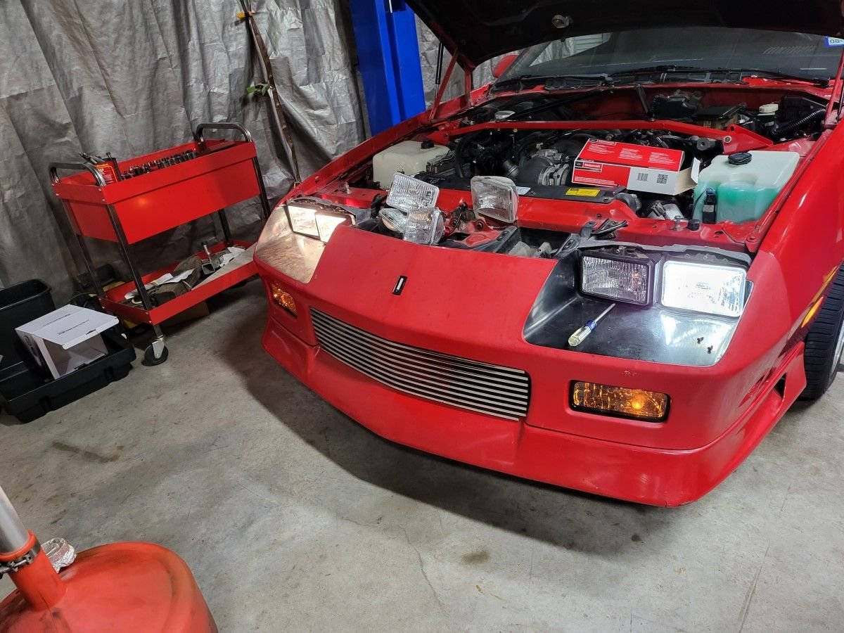

Got my lights in, but not the harness to run 4 bulbs. Did a test fit and they fit just like stock.
Unfortunately, when I plugged in the 2nd light, both of the low beams stopped working completely. I didn't have time to figure out why yet, hopefully there is a fuse or something for the headlights... One worked, plugged in the 2nd, then nothing. Cant test the brights until I get the wiring harness which still hasn't shipped yet.

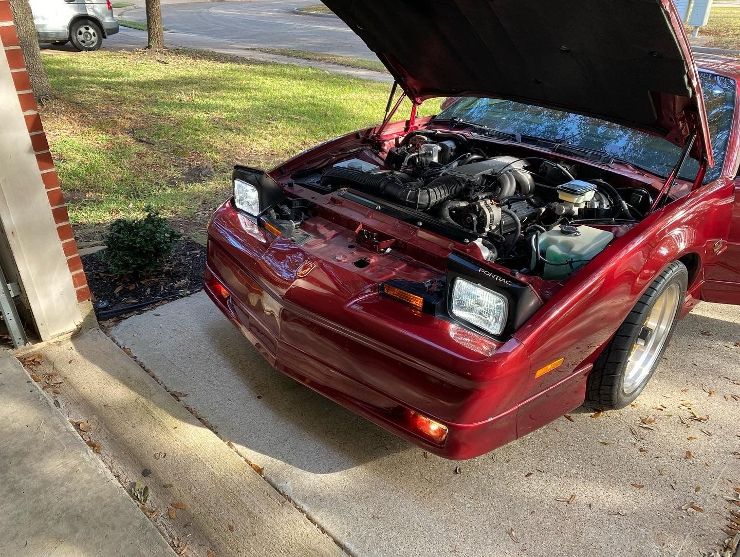

Received my set Friday from Screaming Chicken and installed them yesterday.

That is sooo much nicer than stock, or factory or such. Just a nice solid, wide beam of light. Out on a dark road with no street lights that is .....'light years' ahead......

5700K? I think it's important for people who post pictures to let everyone know which color they purchased. Thanks.

Yes, those are the 5700.

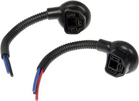

I finally figured out why my headlights were not working. The wiring harness they sell you has the ground pin on the wrong side, as well as they have the brights tied into the the low beams.... this means even after swapping the ground pin, you always had all 4 bulbs at high only. I ended up cutting up the harness and rewiring them to be stock. Outside for low beam, inside for high beam.
Why not de-pin and move the wires?

Too bad you had to go through all the extra work.
Re-pinning plugs on aftermarket headlights is pretty common for older cars like ours. TGO members have had to do it with other models of new LED headlights. And the harness they include is specifically for running all four lights together, all as low beams, then all as high beams when so triggered. It's an optional feature, not mandatory to use it.
HR has several videos for the Retrobrights, with some being actual installation videos. Chris might not have covered the pin situation in the promotional video, but IIRC, he did cover the use of the additional harness. But in the installation videos, the installers do show the re-pinning of the plugs, as well as how to use the additional harness.
Maybe the instructions didn't cover all of it well enough, because I think you might've more work for yourself. But at least you seem to have gotten everything working now.

After about an hour of trying every combo possible with the harness blown apart and using wire nuts, there was no combination that wouldn't cause the brights to always be on. By bridging the low and high beam wires on the high beam bulb they created a loop.

StevenK is correct. The 4 way harness doesn't work not matter how it is pinned. You will need the 3 pin non-standard adapters or cut up the harness to separate the two lights. Once the harness is separated you get four lights on the high beam and two lights on low beam. Holley and Morimoto will tell you that you pinned it wrong and there isn't a problem with their harness (spent quite a bit of time on that). This is for Camaros only, btw. The 5X7 Firebird lights are plug and play with no re-pinning. When you buy the Holley/Morimoto headlights thru Screaming Chicken we repin and include adapters for you so they will be plug and play.
1982-92 Camaro Holley Retrobright Headlights (screamingchicken.com)

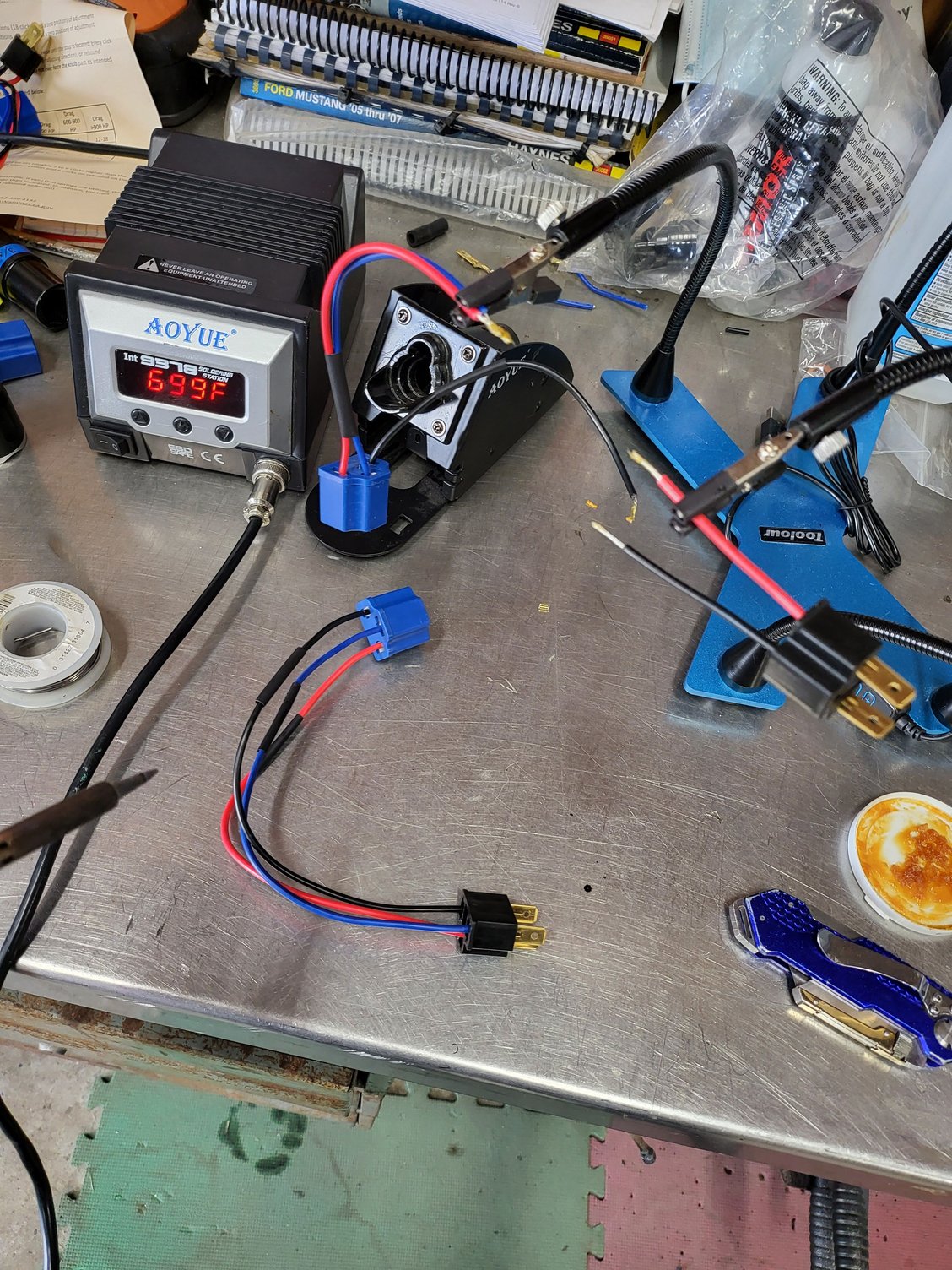

And this right here is why I love the thirdgen community, the Vendor support for vehicle specific parts.

I know it's been a little while, but I just got a pair of these (LFRB120 Classic White) for my 91 Z and when I opened the box I was very surprised to find them very loosely wrapped to the cardboard with saran wrap... I immediately thought for sure, someone had bought them, tried to install them, but then returned them and just grabbed what they had in the kitchen to make them look untouched. There was also nothing else in the box except the bulb/housing. No instructions, and no adapter cables/connectors, as the online manual says are included!
Straight out of the Holley manual:
Now, looking at your picture and others I have found on the web, makes me think this is really the way Holley packaged them?!?! Can anyone else share how theirs arrived please?
The other thing that concerns me is that the housing was so loosely wrapped, that the little nubs on it made many marks on the inside of the box from the housing/bulb repeatedly slamming against it during shipping/handling. Shouldn't I be worried it could be damaged or have a reduced lifespan do to this? Or, is this really how they all come, and I should just re-pin my factory connector and move on with installing them???

That is the way they come from Holley/Morimoto. We sell them, but we make sure the adapter is included, add 3rd gen specific instructions and add more bubble wrap before shipping them.

@scfbody: I'm starting to wish I had ordered from you guys...
So what you're saying is that the loose flimsy saran wrap packaging is the norm, but there should have been some generic instructions and the adapters they mention in their generic instructions?
Anyone have any longevity issues as a result of the loose packaging?

Your correct on how they are supposed to show up. Fortunately, we haven't had any failures so far. Due to the price point we don't sell a lot of them but the ones we have sold haven't had any problems.

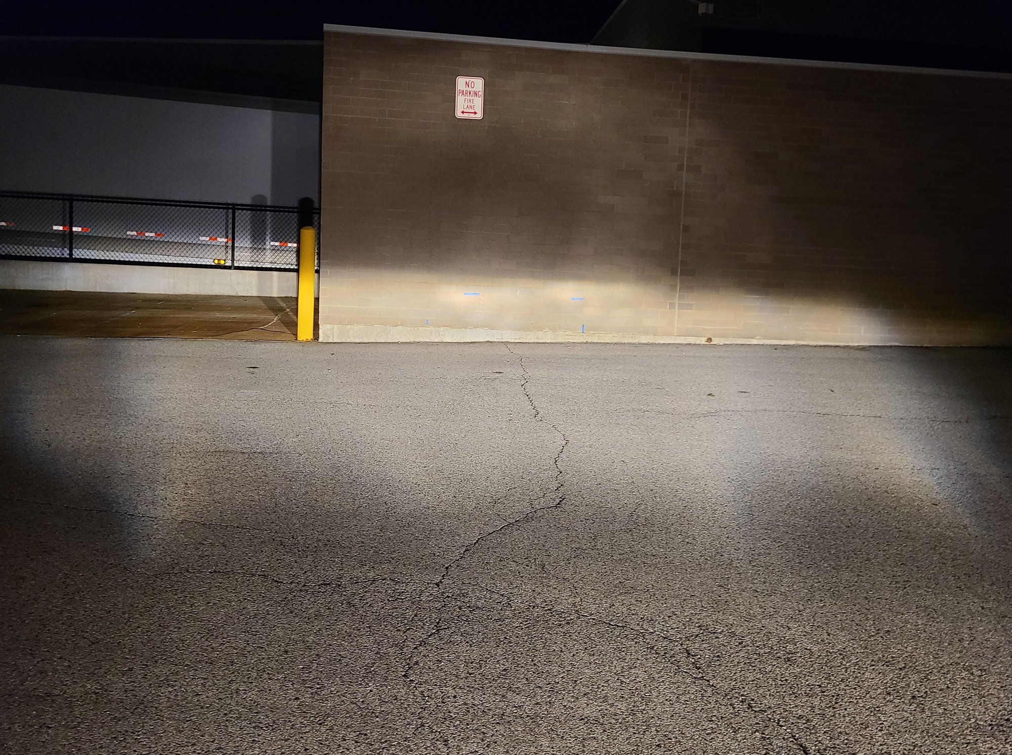

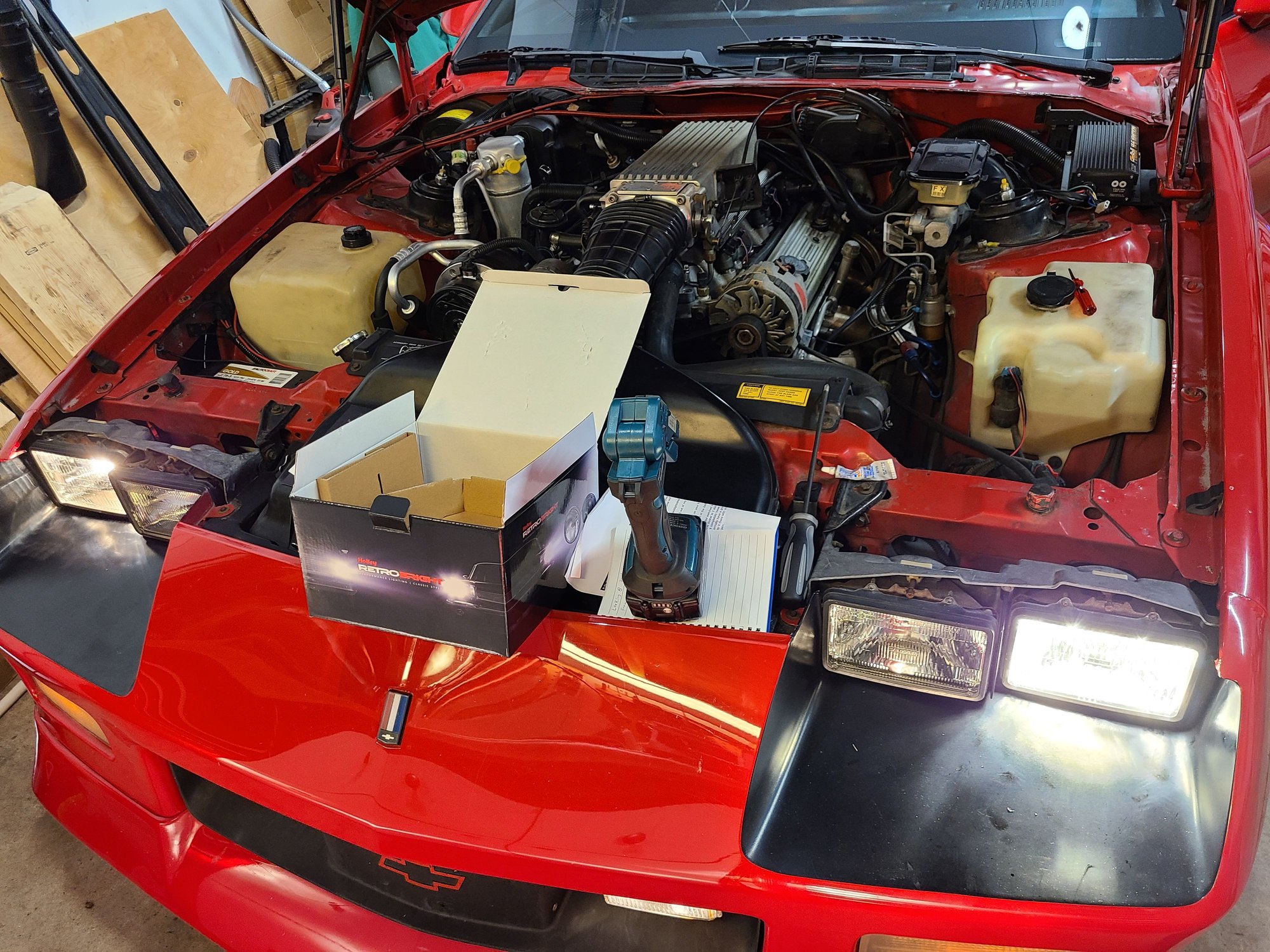

@Clubber I'm not certain I understand you. I think SC sells the Holley Retrobright kits, but also sells some other LED and Halogen conversion kits as well for our cars. He should be able to clarify for you, or just browse his site.
I went back and forth with my vendor, and they confirmed the packing is normal, they claimed only to avoid scratches during shipment. They also agreed to send me out the adapters, but we'll see if those ever show up. Since it was so simple, I just ended up re-pinning the factory connectors, and installing the new lights. They are WAY brighter than the old sealed halogens! They throw a much wider pattern too so you can see the road ahead but also the shoulders of the road on both sides. I feel like if there was a deer waiting to jump out I may actually have a chance of seeing it now! Aligning them was a little tricky, but I think I got it about right.
One tip I would give thought and I feel stupid for not realizing it right off the bat... Make sure you use a smooth chromed or polished screw driver for installation and adjustment. I used my extra long one because it made things easier but it has a phospated maybe black oxide finish that is almost like that of maybe 800 grit sand paper, I'm pretty sure there is no way to keep the screw driver shaft from rubbing against the headlight surround in the bumper, and mine made a few little marks in the paint, not a lot, but I still wish I had used one of my smooth ones that wouldn't have done that...
Behind the local Walmart trying to get the pattern right.
Left is factory style sealed halogen (Wagner?), right is the new classic white Retrobright.

That isn't the issue. The lights have terrible focus and aligning them is kind of pointless.

We sell United Pacific and Holley headlights. Aligning either headlight properly will make a difference in the performance of the headlight. The United Pacific headlights have led bulbs that can adjust to change the beam pattern, that would help with the terrible focus. I believe we talked on the phone in the spring and went over how to adjust the beam pattern. The back of the bulb turns to change the beam pattern. You can also remove the bulb from the light and rotate in 180 degrees which flips the high beam and low beam part of the bulb. Once adjusted correctly the United Pacific beam pattern looks similar to the Holley picture raptere posted above. The Holley headlights have a better cut off and the beam spreads out more, but they are also double the price compared to the United Pacific headlights. We do not design or manufacture either one of them. We supply any needed hardware, wiring adapters and install tips on how to install as easy as possible and make them work as well as possible in 3rd gens (Camaros & Firebirds).

Alignment should help as the Lamp Assembly is adjusted just like the OEM Sealed-Beam or a Hella Glass Composite H4/ H1 Lamp.
I do not know enough about the Beam Pattern of these (as I have never used them) but @scfbody would be able to Help you.
Optics (and Physics) are actually very interesting.
The Design of the Lamp Assembly and its Components:
The Reflector Surface behind the Bulb, the Shield in front of the Bulb, (some have a Dispersal Deflector, or a Projection Lens), and the Lens in front of the Bulb.
All of which will affect the Light Output in several ways.
Those Lamps should have all of the same components (less any Projection Components) and be adjustable via the OEM adjustment Screws.
The more advanced Bulbs (LEDs or other) further complicate things...
Thus the reason that I personally like to just use Hella glass H4 Lamps, and use 9005/ 9006 HIDs on H4 Bulb Bases.
It works wonderfully!
