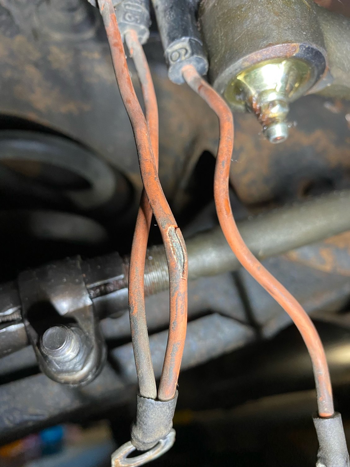

One day recently I started the Z28 up and discovered half the the power was out in the car. My free time is precious, and thanks to all the good info on ThirdGen I knew exactly where to go looking. The one with the split was stretchy like a rubber band and failed the ohm test. The other two ohm'd out ok but I'll be replacing them too of course. Carry on!
