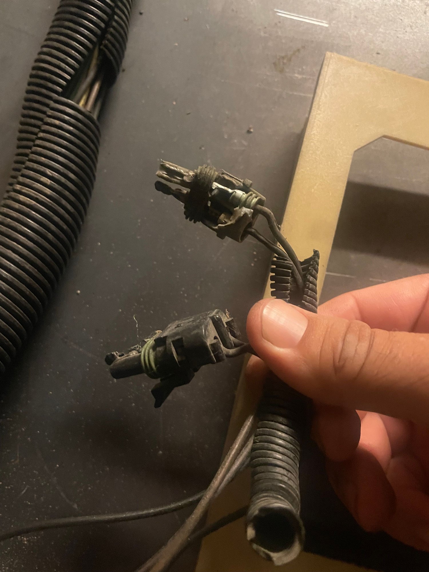

Finally got a chance to look at this wiring harness. Looks like it has a few broken connectors and I’d like to order new ones. It’s a 1986 TPI harness and the engine will be a L31 originally a 305 TPI.

It looks like the first two seem to be for the AIR pump solenoids just above the pass side front exhaust manifold.
The second looks to be the IAC.
And the third should be the transmission connector.

Where’s the best place to order them ?

Trans connector is a Dorman number 85182.
The IAC GM number is 12085506, or Dorman 85112.
I would try AutoZone or Summit...
