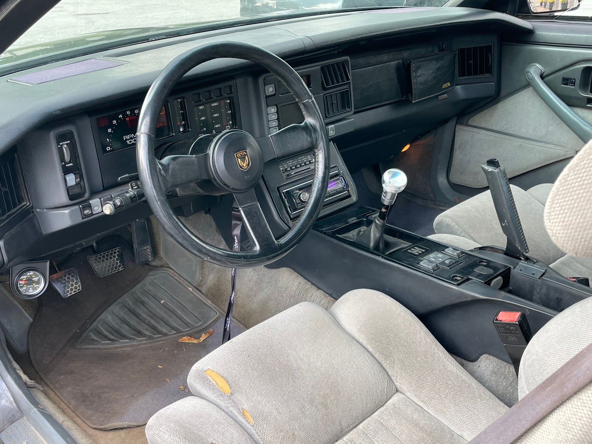

I just picked up this 87 Gta and its in need of repair. back in the day I know a few older members offered services for repairing boards and fixing odometers but now Im one of those older members and doubt theres much support for these rare dashes or spare parts. I definitely need the odometer either fixed or replaced. The car I just got is unknown mileage after 220,000kms and its a fairly clean car. The speedo only reads mph even though I press the e/m button to switch to km/h will only display that for 2 seconds and switch back to mph(Im in Canada). The temperature gauge does not display a reading at all and in general all of the lcd displays seem very dim, Ive seen fully operational dashes and they are easier to see in daylight and great at night. This car is not that. The car did come with a few spare digital dash parts but if theres still someone on here who repairs these things id gladly send them over for a overhaul. I want to ls swap this car and use the digital dash and digital hvac controls.
Any help or suggestions of places that would tackle this would be great. Otherwise..who has parts for sale lol.

You might try AER Technologies in Southern California. Back in the day, they were the company that repaired these for dealer warranty repairs here in So. Cal. I know they’re still in business.
