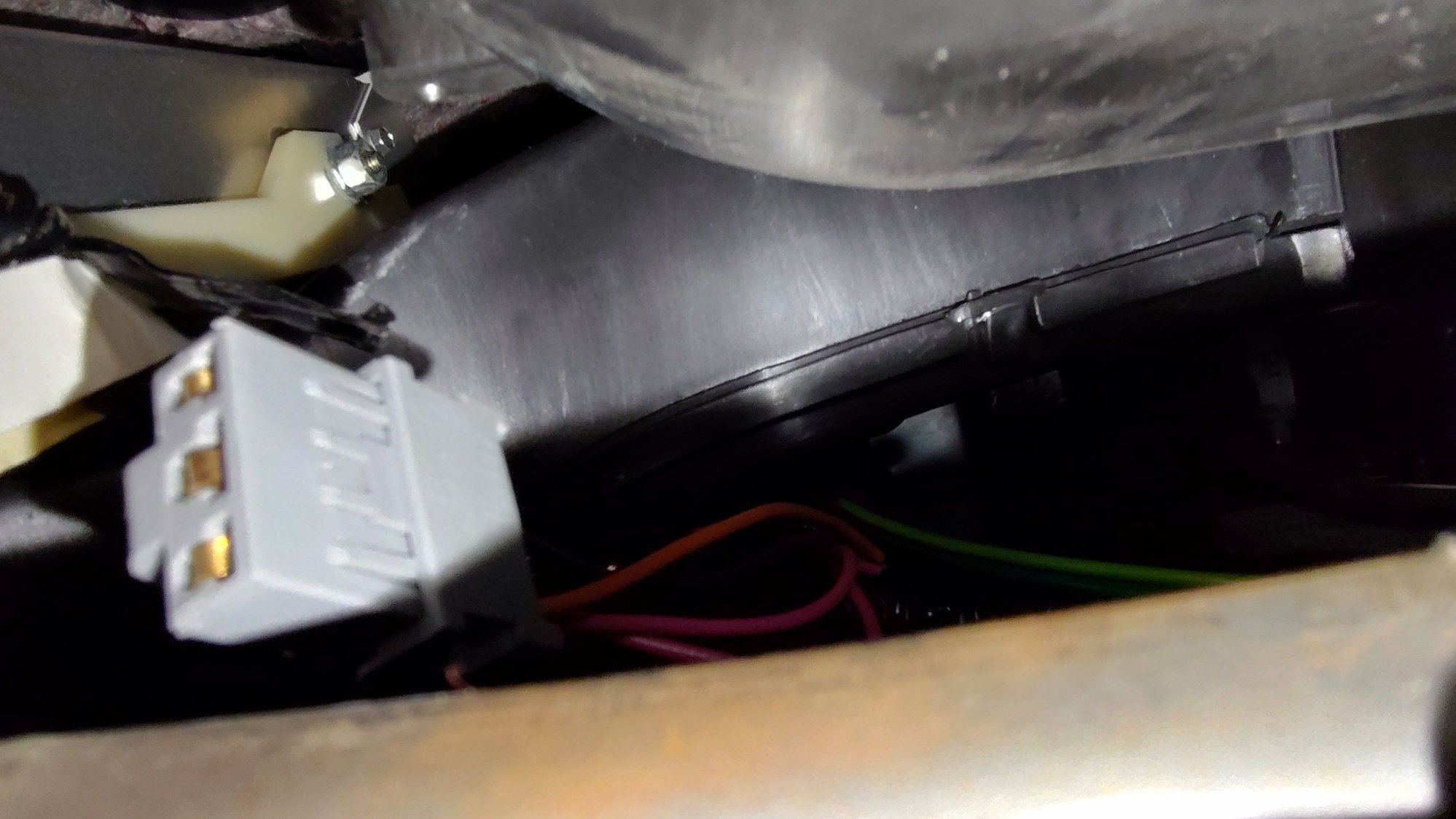

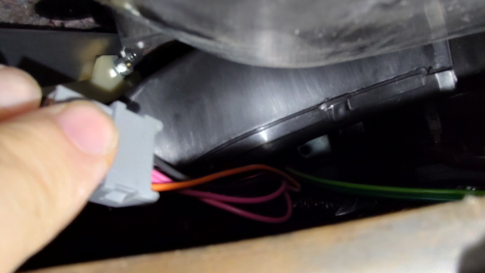

What is this gray connector for, next to the ECM above the passenger footwell? Unused in my RS, but I am looking for an "ignition on" source. Wire colors are two pink, an orange and a black.

It looks like a power antenna relay connector. (not sure why it has 2 PINK wires,.. but it looks like a power antenna relay plug)
ORANGE should be full time battery voltage
PINK should be switched voltage
BLACK is Ground
Use a voltmeter to verify.
