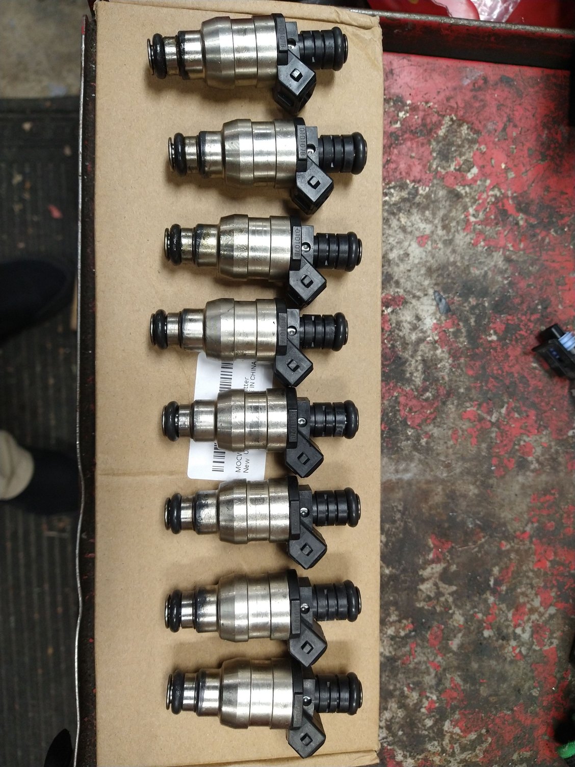

8 Accel 26# fuel injectors for sale. Only top tier premium fuel used. $150.00 with free continental US shipping.
