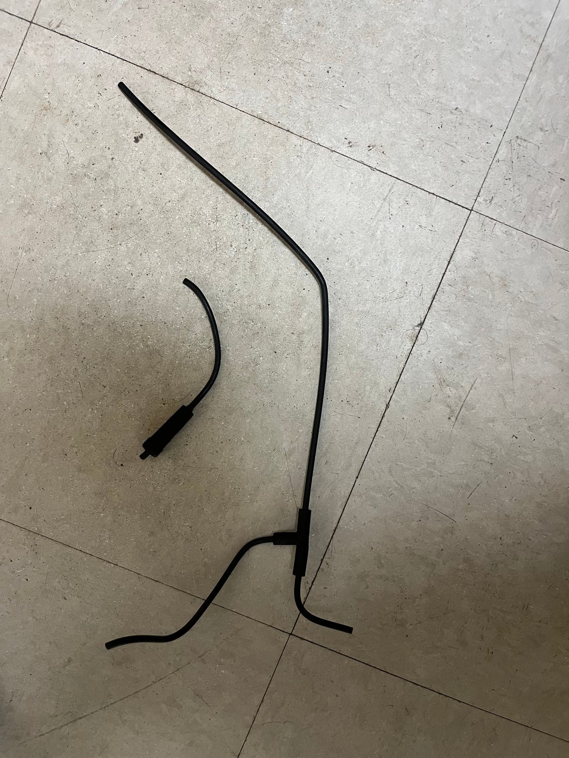

I need the hard line for a 1988 camaro with a 5.7 TPI motor. It broke coming out of the car, or if nobody makes them a good way to go about replacing it. Car is dead in the water until then.

Dorman sells hard tubing iirc 5/32
https://www.autozone.com/fittings-an...ing/365574_0_0

Unless you buy a nos set, you'll buy bulk tubing.
If you want it bent, you'll have to heat it, bend it, and let it cool in to shape.
