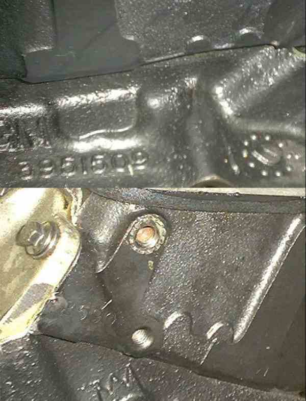

2.02" intake valves are rare in a factory motor. I have yet to see a full-size car that came with them. I had a 68 Impala, the top-of-the-line full-size car, with a 327 4-barrel; it didn't even have double-hump heads, let alone 2.20" valves.
What casting # are the heads? Maybe you can trade them to somebody for some ones that will work in your car. Although that's getting harder to do all the time, nobody wants stuff that won't fit in any car made after 69 except people doing an original type restoration, and unfortunately, nobody's restoring 68 BelAirs that I've seen.
Here's the heads you want. You won't find them on a 327 though. These are 186 castings, from a 69-70 350 or 302. And no, that's not a 327 block, or a 350 either.
