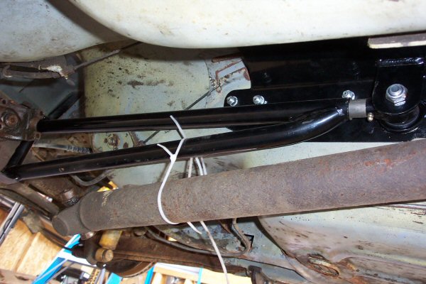

the torque are that i used

can you tell us something of the torquearm and setup you used, it looks like one for a 4th gen. Is it? what is it? I have seen it before I just don't remember where.
I had a caddy 472 I considered doing this once, I was going to use a TH350 though.
considering that if a 9 or 10 second foot brake drag car can use a th350 without failure then, hey why couldnt a 12 or 13 second car right?

it's a jegster torque arm from jeggs.
