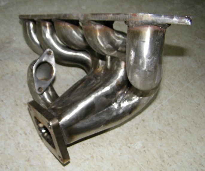

I know where you can get a nice turbo manifold for the H3

A 3.7 would be a LOT easier. No custom pan needed, no custom pickup needed, no need to customize the cam cover. Factory flywheels/clutches are available for the 3.7 too.
