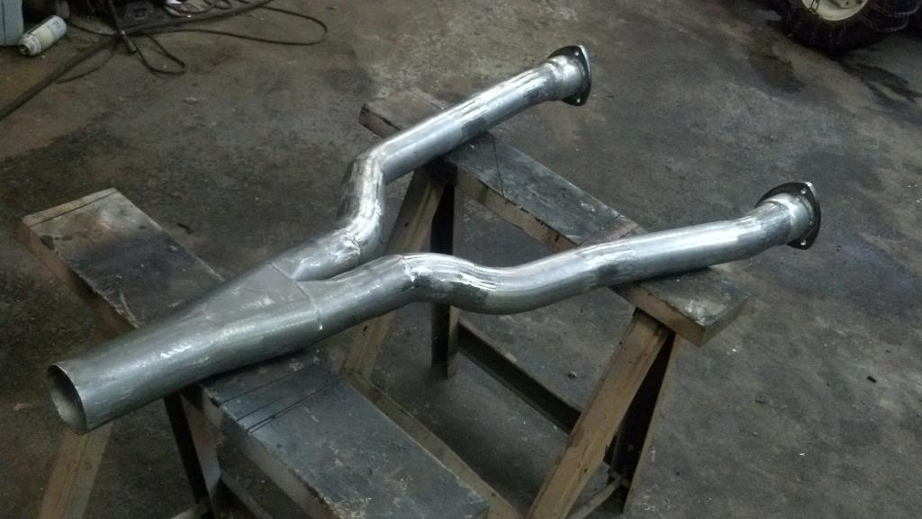

I finally got the y pipe built it turned out pretty good.

Nice y pipe! What size tubing did you use?
Old Mar 10, 2013 | 05:51 PM
  #64
TORN's Avatar
iTrader: (17)
Joined: Jan 2008
Posts: 329
Likes: 14
From: Grand Rapids MI
Car: 88 IROC-Z
Engine: 6.9L TPI(FIRST) 421ci
Axle/Gears: Ford 9" Eaton truetrac 3.50
Re: FFI First Injection 421 ci TPI
I really like your pulley system, what are the pulleys and brackets you are using?
Austin (BIG_MODS) Hand made the pulley setup so it is a one off setup. I bought it off the classifies on here.
The Y pipe is 2.5 pipe into 3 merge which will hook into my 3 inch Magnaflow cat-back. I know some will say its too small for a big inch motor like this but this is not a super aggressive cam so after I get it tuned and on the road I can revisit things like the stock intake Y and the exhaust and change whats needs attention.

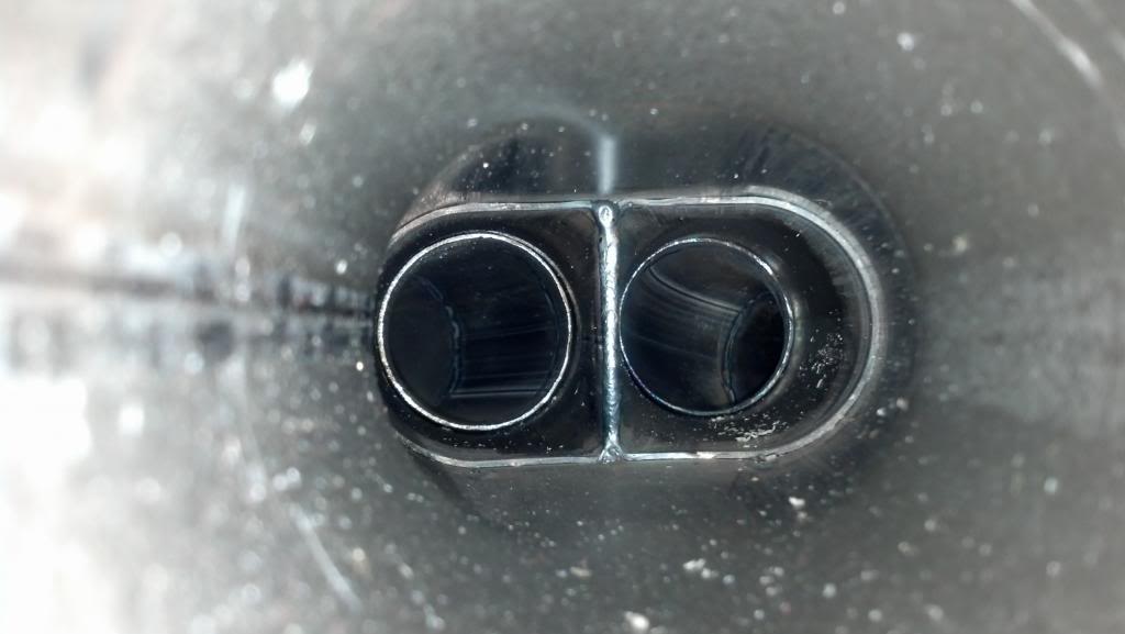

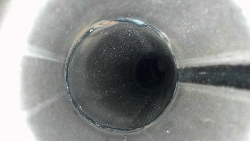

Welded in O2 sensor bungs and put 3 coats of VHT Header paint on the Y pipe. My list is getting smaller I am only days from firing this thing up. It will have to wait till after my trip to Bristol Tenn. this weekend.
It doesn't look like it in the pics but the lowest part of the Y is a good 1/2 inch higher then the collector flanges.
