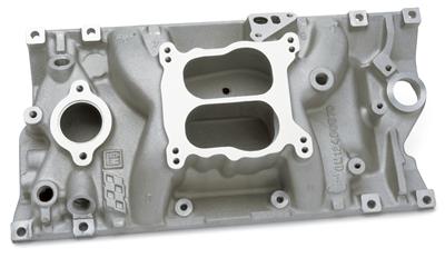

Originally Posted by naf
The vortec Performer won't have a boss for the EGR valve.
The GM version does: http://www.summitracing.com/parts/na...make/chevrolet
(Supposedly it's made by Edelbrock, a Performer with GM markings.)

Never noticed that, but, OOF, $320?
Wonder why, or how it's plumbed.
Still would be missing the fitting for the EVAP's TVS, at least not in the stock location. Did 86 use the TVS or was it computer controlled like the 87 LG4? 86 was kinda a bastard year for a lot of stuff.

'86 used the TVS for purge and EFE. One in the manifold, the other on the thermostat housing.
Looks from the pic the port is there:
Pace seems to have the parts for EGR:
http://paceperformance.com/i-6255260...-with-egr.html

but the stock location for the purge TVS should be front, right of the water neck.
I also dimly now recall considering retaining EGR function when I did the swap oh so long ago. Went with the standard Performer. Super happy. The only serviceability issue I've had is a little light bucking on down hill coast/decel when the converter is locked. Otherwise good performance vs. mileage.

Looks like the vortec performer has a fitting for the purge TVS, left of the water neck.
