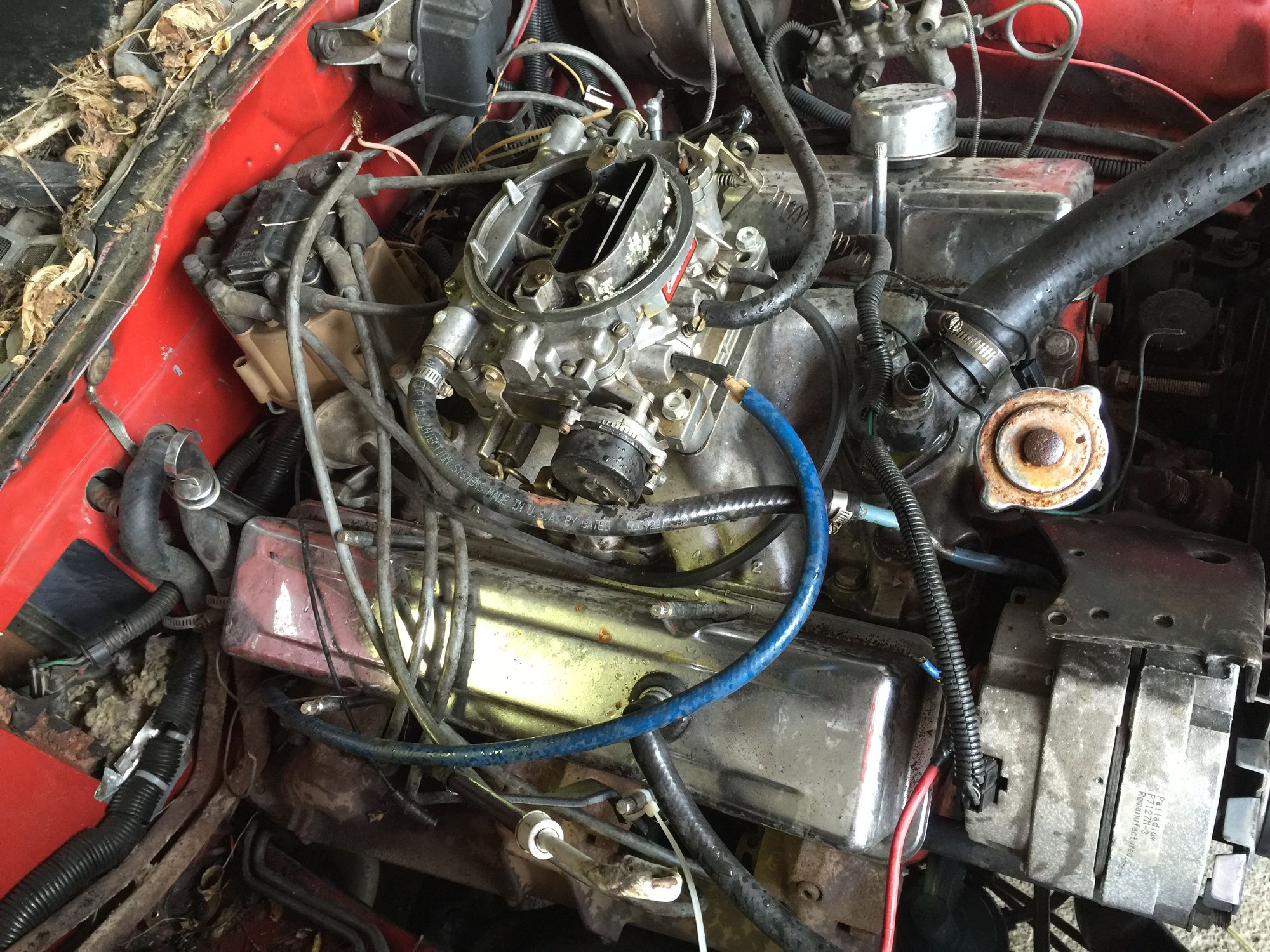

V8 Camaro in to a v6 Firebird
I need to know what will need to be changed when I do this swap. Will the master cylinder in my v6 work with my Camaro v8?
I'm using the Camaro engine mounts.
Will my back axle/differential work with a Camaro V8 in my Firebird v6?
I need help with this! Please?!
Camaro 5.7
Pontiac 2.8 liter
